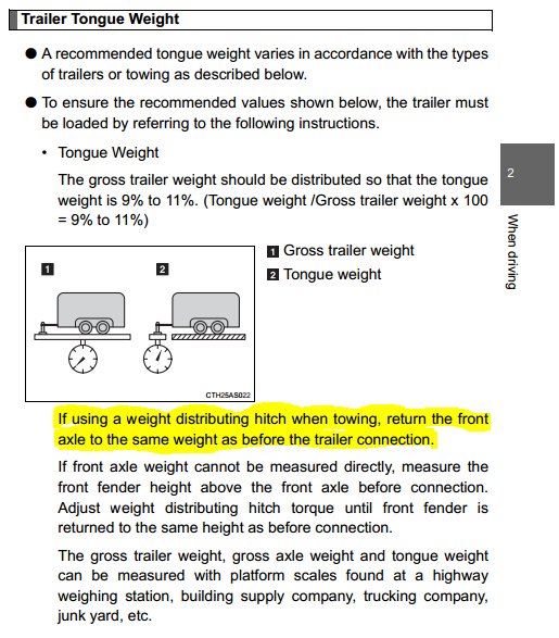

And it looks like you used a WDH setup, did you install a different hitch on the 4runner? From my understanding the factory hitch is not to be used with a WDH configuration since the factory hitch is attached to the cross member and not directly to the frame.
This is oft-repeated, and I think it actually comes from the 4th-Gen T4R owner's manual. The 5th-Gen manual doesn't contain the same warning, in fact the US version doesn't mention WDH's at all. However, the Canadian version does, and it says it's okay, so long as you don't redistribute too much weight back onto the front axle (in other words, the manual suggests that you use your WDH correctly):
I also contacted Toyota directly, to see if using a WDH would increase my allowable tongue weight (some manufacturers give two max values - one with a standard hitch, and a higher number with a WDH). They said, no, the tongue weight was the same (interestingly, they quoted me #550) either way - however, they did not say not to use a WDH.
I couldn't imagine towing maxed out as I was without a WDH, and air bags are a nice plus, too. Honestly, I feel like I had a whole host of incremental improvements that made my tow a success (in addition to previously mentioned WDH and air bags: LT tires on truck, lightest trailer I could find, low center of gravity of load, torsion axles on trailer, ST tires on trailer, Tekonsha brake controller, etc.).

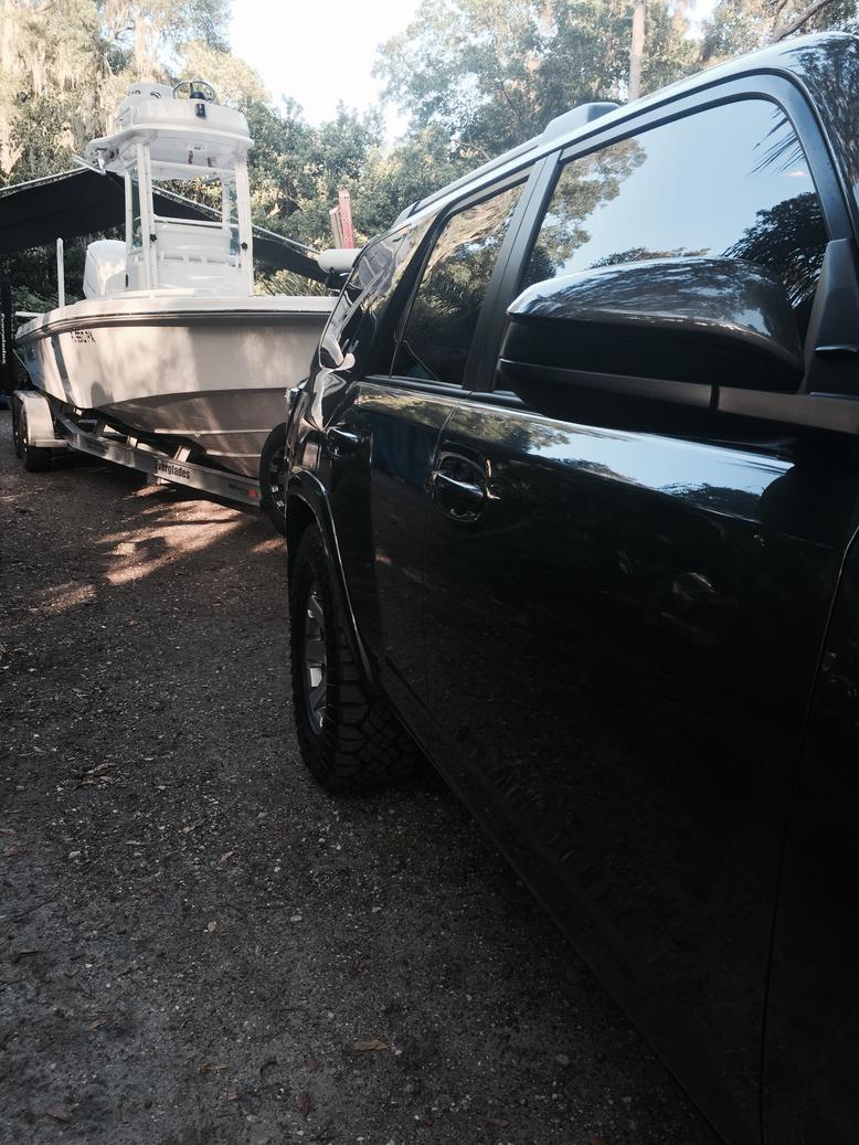

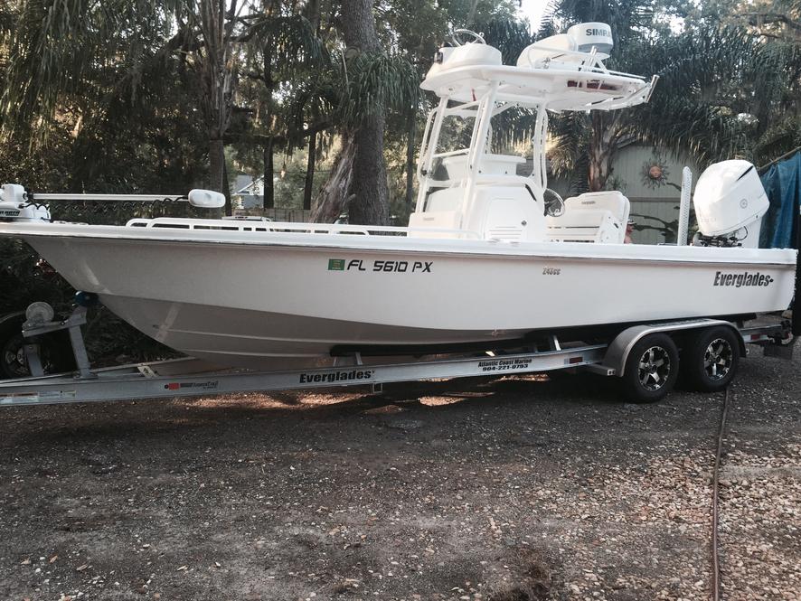

Everglades 243cc. About 6100 lbs
Pulls great at 65mph with no issues. I have 285s and trd pro shocks with spacers set at 2.5 total lift in front. Boat weighs 4100 dry without the tower. Had full tank of fuel and the trailer weighs around a 1000lbs. Has trailer brakes.
