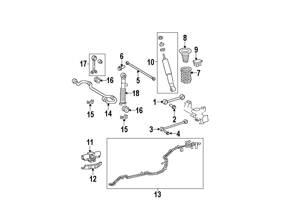

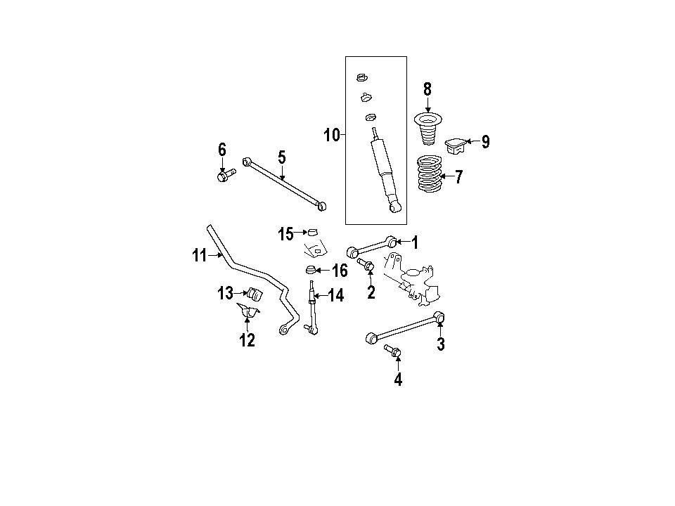

Yes, sorry. The KDSS system is totally different and these links will not work on KDSS applications. See images attached; the top image is KDSS with a totally different way of connecting sway bar to frame, part #14 of the second image shows the non KDSS setup and rear link that connects sway bar to frame. I have yet to see anyone come up with a solution for stronger KDSS components. :sad::sad:
