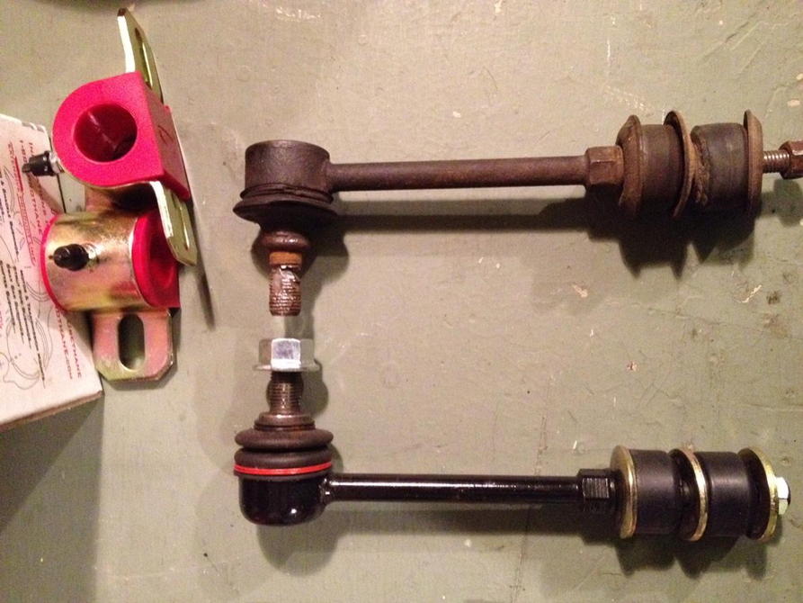

I just got all of the parts today. I went with the Deeza End-Links (same PN's as first post) and Prothane greasable bushings. Same kit really. Total cost is around $127, but I spent $20 on end-link bushings that I don't need (they came with the deeza's).
Now I have to find time to install it this weekend.

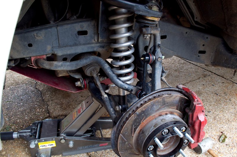

**Install note:
I found that I needed to use my Dremel tool to remove some of the rusted bolts for the Tie Rods; if you run into this to, just run to the Hard Ware Store buy a pack of HD cutting blades for your dremel and saw them in half (10min of cutting each). Otherwise use the correct chuck to keep the tie-rod ends from spinning.
:withstupid:
Also don't spend to much time trying to align the Sway bar bushing bracket *perfectly* its not an exact fit but if you crank it down it will do the job just fine even if it looks 1mm to the left/right.
Let me know what you think of them! :tongue:
I'm only 35 miles from you. How do you have so much rust? It all looked pretty good & clean under there when I checked last week. Still, I'll hit it with some liquid wrench stuff the day before.
Which links did you use the stacked washers on? Front or Rear?
I finally got around to installing mine front links this afternoon and I didn't have to use any extra washers, everything tightened down fine with an Allen wrench and 3/4" wrench.
I'm looking for heavier duty adjustable sway bar links for my rig but I have to say, just looking at these compared to the originals; they don't look any stronger or better made.
Is there something about them that the pictures don't convey Talon ? Not bashing your choice in any way, just not seeing the difference is all. They look pretty much the same to me.

It's been a couple of months, but I recall thinking the same thing. The Deezas are greasable, however. I believe the main benefit was from replacing the rubber bushings that came with the end-links with Energy urethane. I think it was $17 shipped from Summit for an 8-pack.

Thanks, its all about what you are going for... yes it does allow for more articulation but I do more HWY/then OFF Road so its smart to keep it on there. I have less pull from ruts and less dancing then I would without it the same goes for the Heavy Duty links, its made turning and HWY ride much nicer.
the plus over the OEM links is (hard to tell but the boots are thicker and sturdier/ greasable ends and a little longer then factory allow a slit bit more flex)
the reason for this upgrade in the first place was because my old ones were totally hosed (boots shredded {in pictures}, no grease and lots of squeaks)
all better now and they are still holding up perfectly. money well spent if you do lots of MILES HWY.
