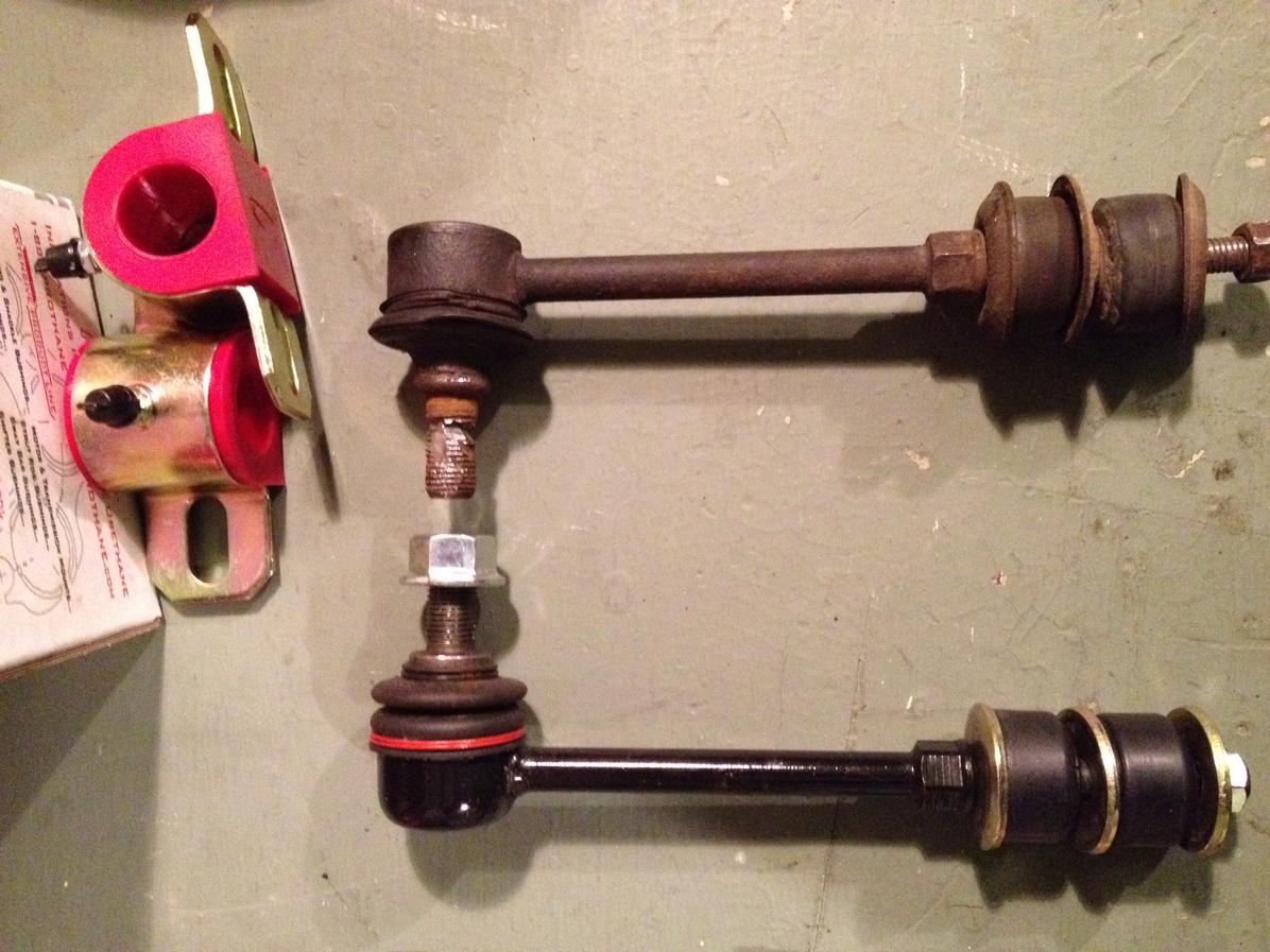

Just purchased some Heavy Duty grease-able link ends from Rock Auto.
$75 for all 4, + I upgraded the sway bar bushings to grease-able Prothane bushings!

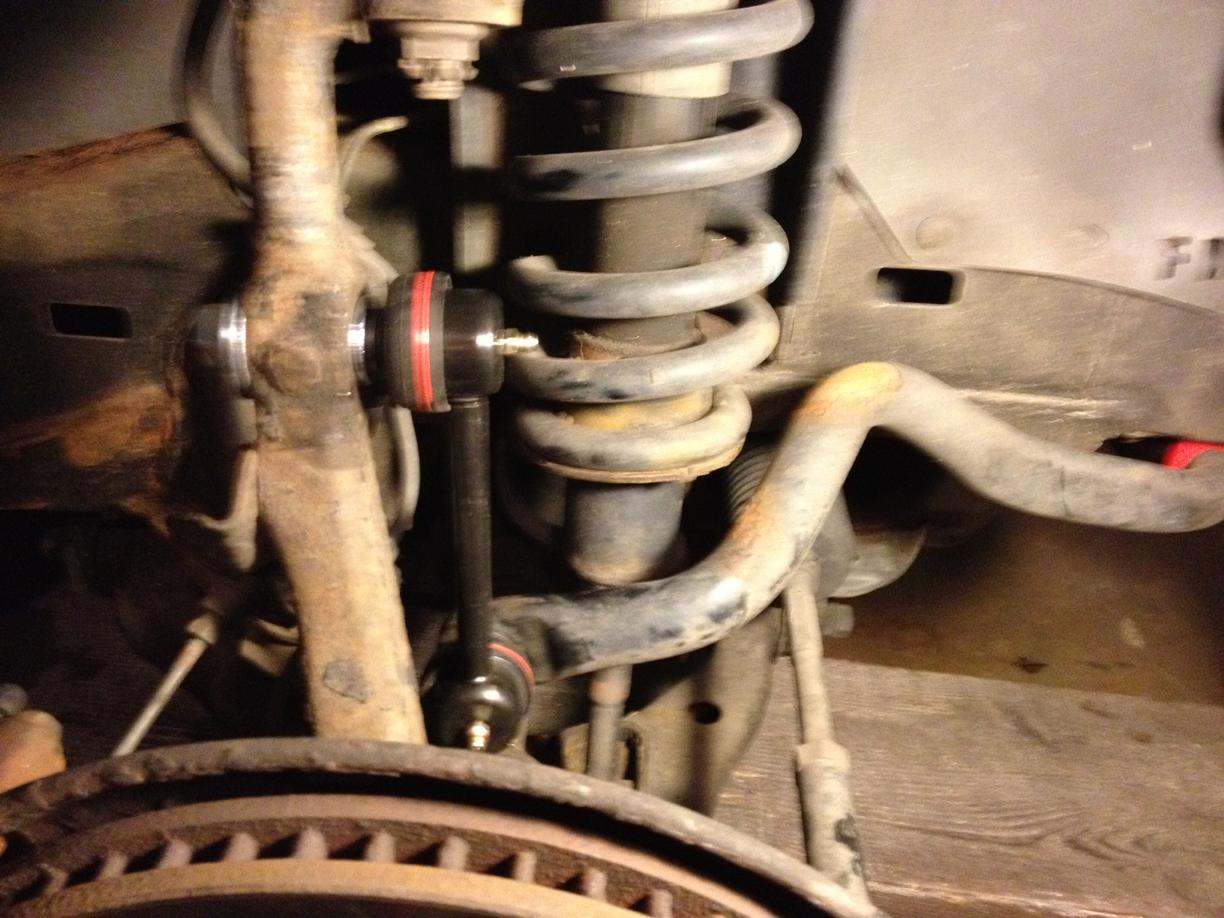

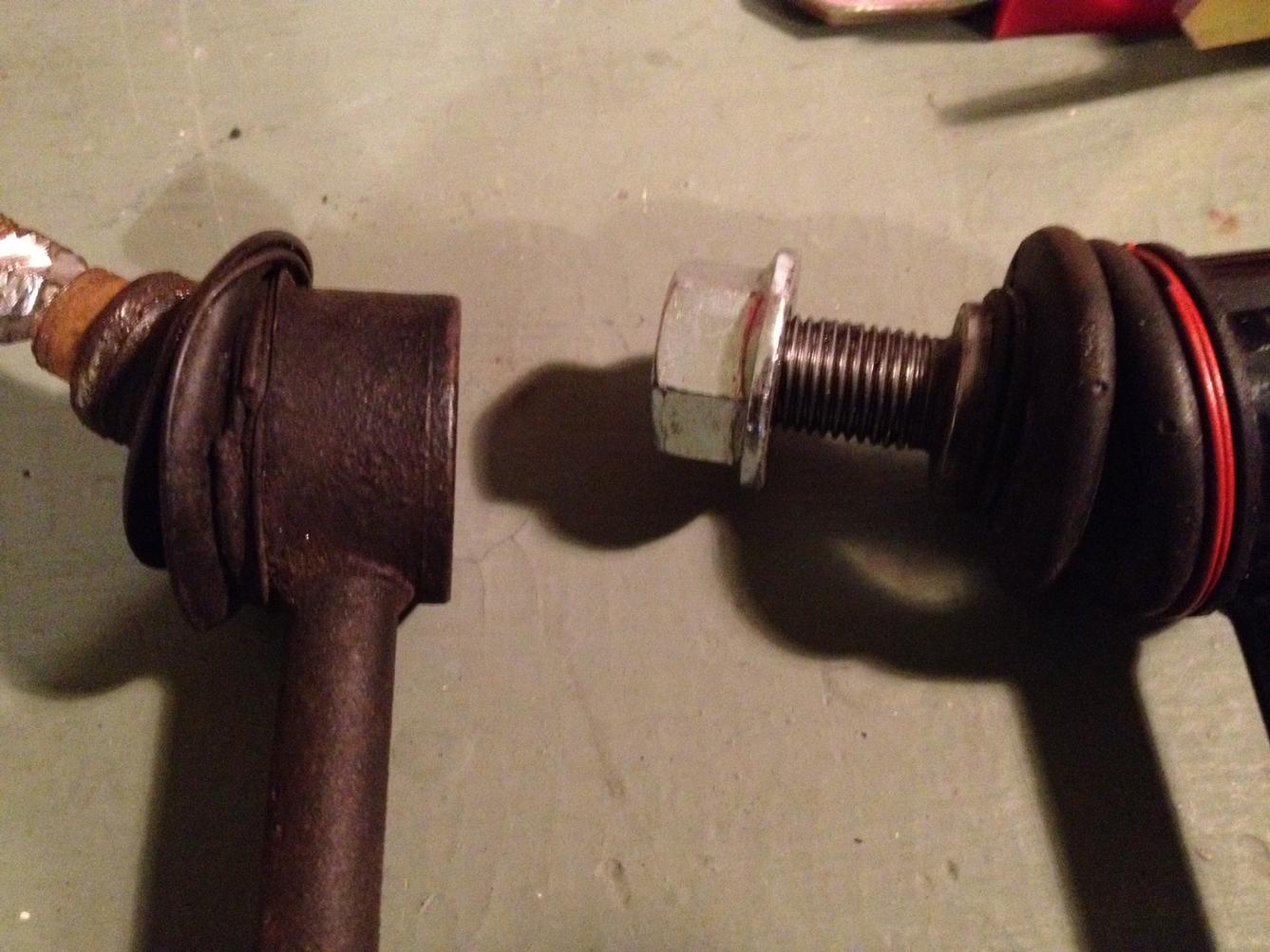

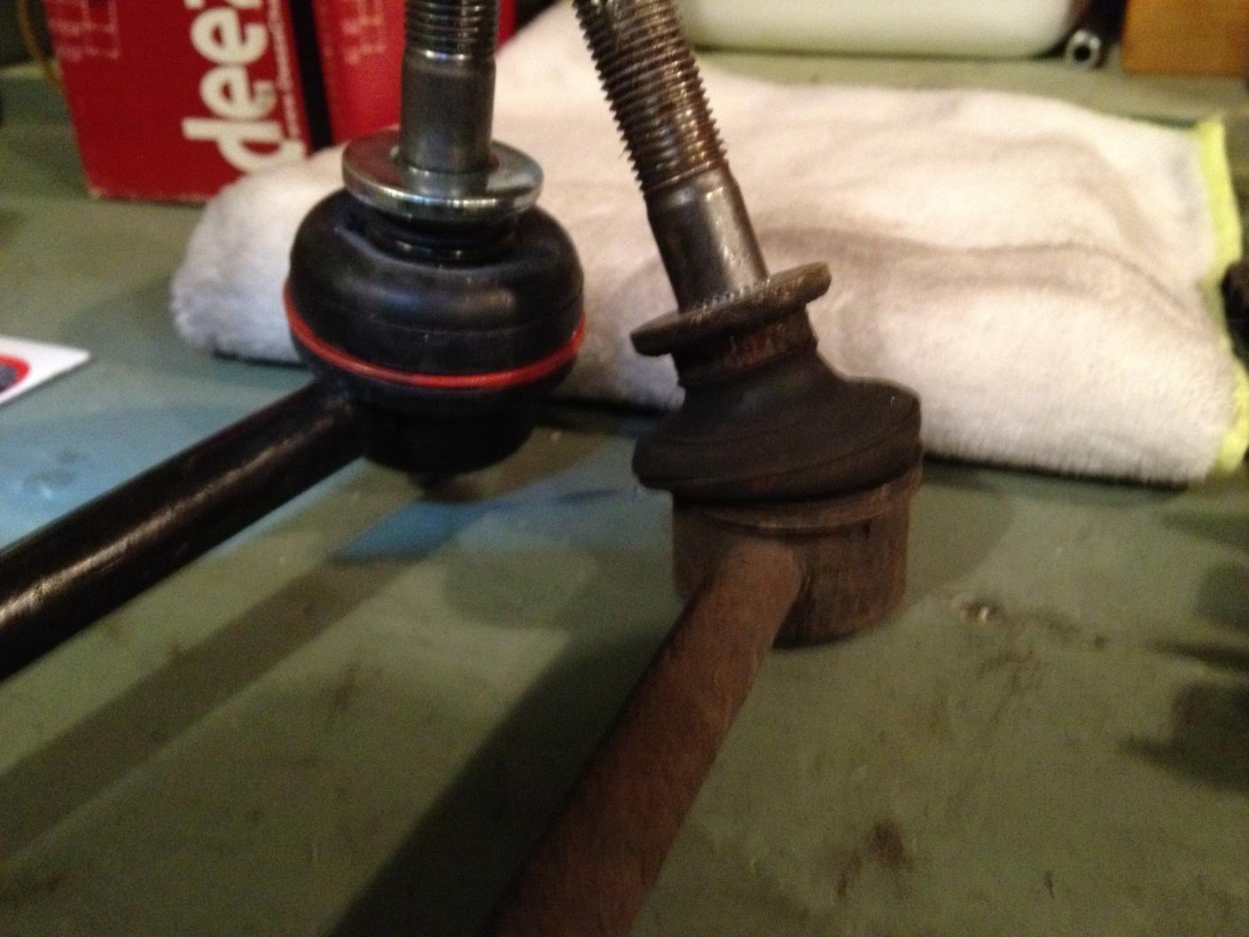

Installed and Review
OK so here is how it all went:
I came to realize that nearly all of the bolts needed to be hacked off. Not too hard if you got a dremel tool and a few HD cutting blades.
As I stated previously all of my ends were SHOT; and instead of replacing them with parts that eventually fail, I spend $75 for a total hookup and replaced the sway bar bushings and tie-rod ends with Super Heady Duty parts from Deeza.
I will complete this post with a bunch of pictures detailing my process in general.
**All in all it made a much greater improvement then I could have predicted. Before when I made a turn or changed lanes I seemed to feel a little out of control. I have much less shake on the the highway when cruising and less wandering too! This upgrade has firmed up the turns and sways into a solid predictable precise maneuver. It really is laser sharp, and knowing they are grease-able and really tough (as shown in the pictures below) is an added bonus. I feel like it's a different car all together! Small bumps that would normally result in "bump steer" are reduced 80%... Its remarkable how my 4runner feels as nimble and tight as a sports car. HAHAH:party::party::party:

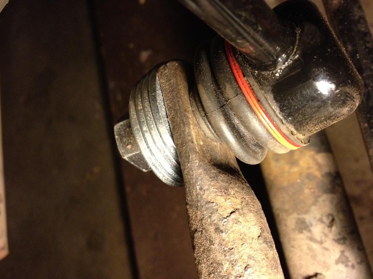

I felt the same way at first but I really don't have a better solution.
The new one's had a lot of space so I put the washers on the outside (not in-between; there is a good example on 4th pic) just to close the space. The fit is snug and feels more than adequate, I don't think warping of the washers will be an issue and I certainly don't plan on jumping a mountain top with my runner. The amount of force that will be applied to those washers seems safe enough for 3 or 4 washers to handle... I will be keeping an eye on it when I start doing a little more Offroad stuff.
I just want people to be aware of this mod, I had great results in the handling and ride department, my truck feels beefed up and making maneuvers takes less consideration for my part and especially when passing or high speed tuns this truck (mind you, I did drive it stock) feels WAY MORE like I am driving a tank its flat and solid.
I think this mod would be less noticeable if your 4runner already has a lift kit, but based on my results it should still add greater stability. I could not be happier. Please feel free to post comments good or bad!
Why so many washers?
:cheers: because it was better then leaving 1" gap at the end link.
I see no problem with it considering the angles and forces being applied. 4 washers should hold up and support the endlink without warping and since I am rust proofing I will give them a coat and seal the deal. If I happen across a better solution than a few washers I may change it out. But until they show any signs of concern I will pass. Besides some people are taking the Sway Bar off altogether, its choice and preference. I do lots of Hwy driving and wanted less swerving and bump steer... I got it.

Washers
So the center needs a chuck to tighten down the bolt without turning the boot end...I hope that makes sense. I could not get a chuck piece to tighten down the bolt so I filled the remaining gap with washers and "Bingo" gap filled, washers snug and end link tightened and installed. if you got the right tools for the job you might be able to do it without the need for washers, I didn't find this to be the case and had to improvise, in all actuality I think it will last the test of time and I will not be messing with is again.
If you can get the right chuck to hold the center from spinning freely then do it right but if you gotta do it like mine I think it will hold up about the same.:roadkill:
You could probably find a steel spacer to replace the washers at your local hardware store or tractor supply... or online.
I scoured the Home Depo but came up empty, most of the spacers I found were made of inferior metals and would probably compress and loosen... I bet if I look hard enough I could find something that would better fill the need.
Thanks!
3/4" steel tubing with an 1/8" wall has a 1/2" I.D. you could cut a short maybe 3/8" piece and paint it black..
