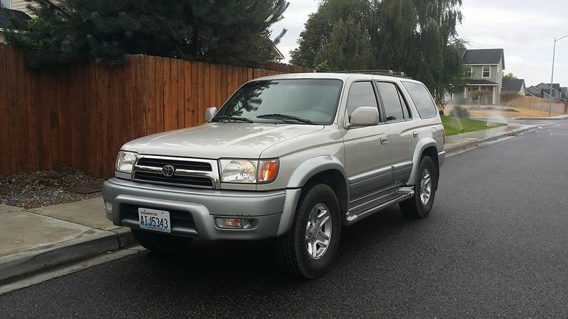

So, after a bit of a search I finally found the one in September of 2015. Here she is in all her glory, pretty much stock with 175K miles on the odometer:

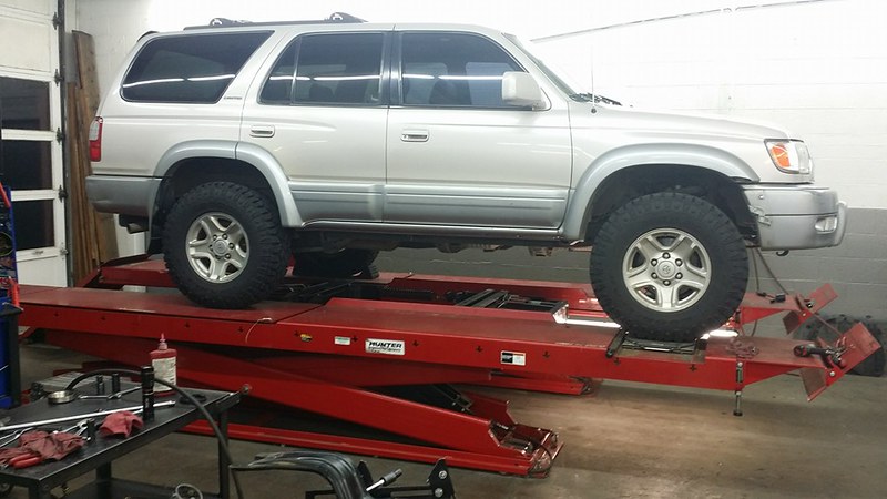

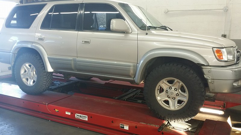

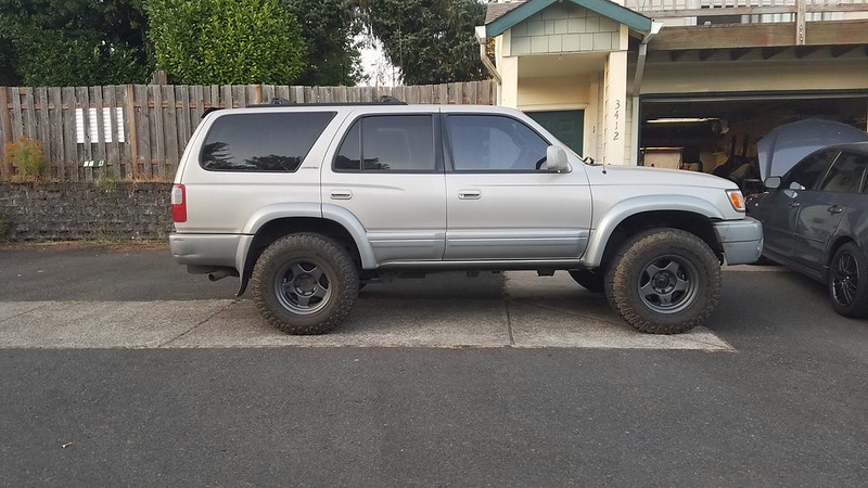

First off, we want to go with a fairly modest and un-assuming look. Smaller lift and armor that doesn't protrude much. V1.0 started with a 1.5" spacer lift on all 4 corners and some fresh 265/75/16 Goodyear Wrangler Duratracs. Heres a before and after we installed the lift.
Then we decided to put some SCS F5 wheels with the 3.5" backspacing

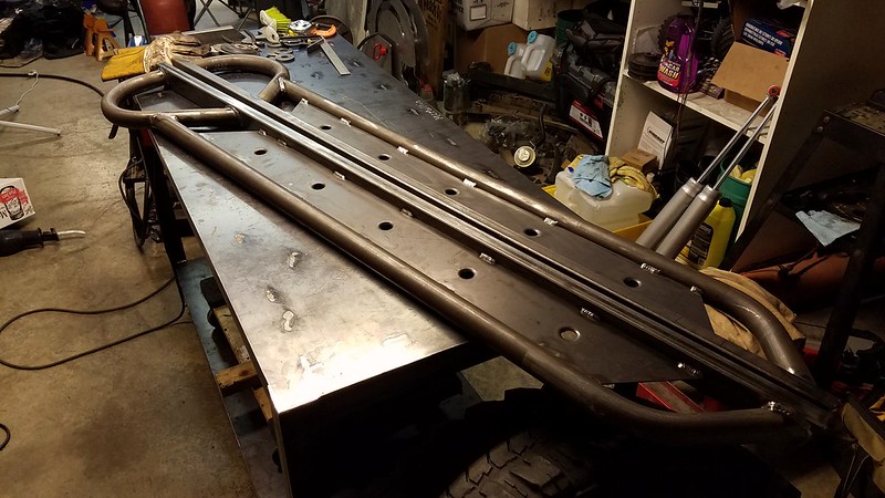

Now for some of the more cool stuff. My BF is a machinist and fabricator by trade, so that allows us to have some neat custom stuff. He built these low profile sliders and they will be installed pretty soon. They will be tucked in real tight and just serve as basic rocker protection and a nice step to access the roof rack a little easier.

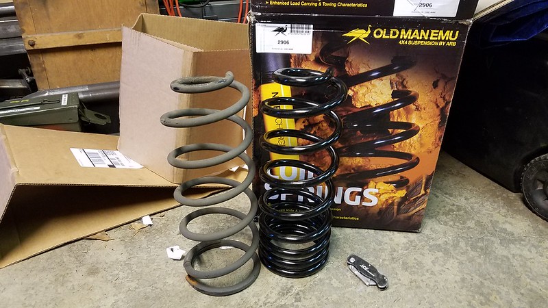

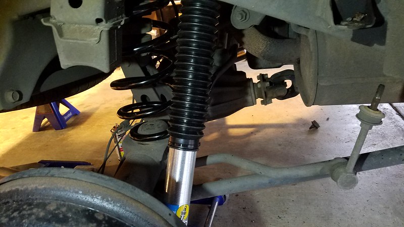

Suspension V2.0 will now consist of Old Man Emu 906 rear coils and Bilstein 5100's F/R. Today he got the rear installed and it rides surprisingly well! We went this route because we wanted to keep about the same lift as the spacers provided, but delete them and some of the complications that come with spacer lifts.
Saturday we're going to a good friends suspension shop to install the front 5100 struts and new OEM lower ball joints. Excited to see how it looks afterwards :guitar3:

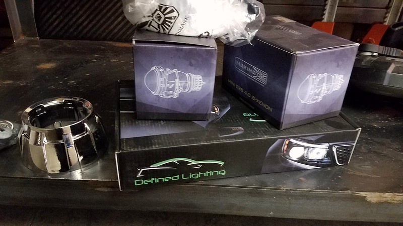

Another thing on the to-do list is a projector retro-fit. We have these laying on deck ready to be installed soon.

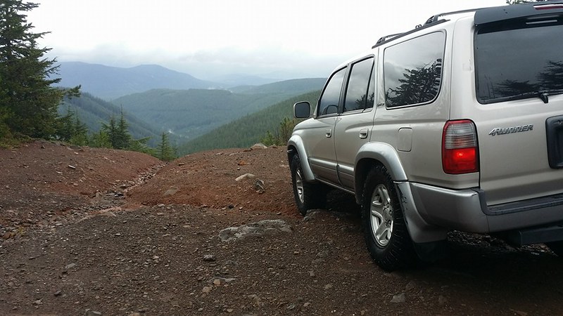

Heres a few photos of some of our adventures in our trucks. We really enjoy wheelin', camping, and "Overlanding". Hopefully with some of the new upgrades, we can start doing more of it in my truck.

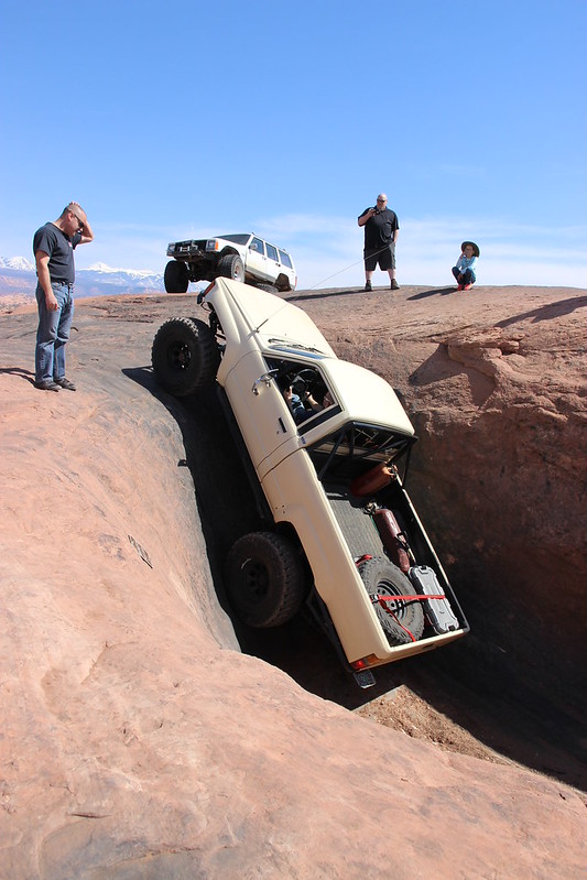

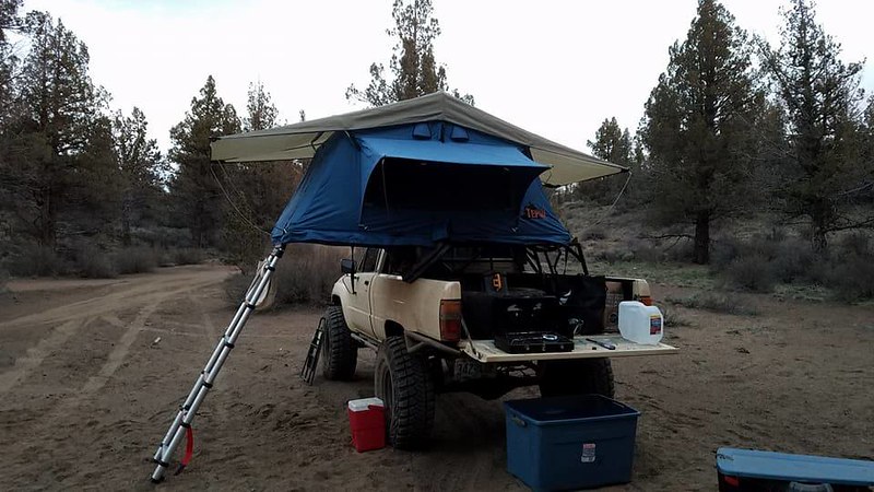

Heres out RTT in action on top of our 85 pickup, and a couple from 2017 Easter Jeep Safari in Moab Utah. Its our 2nd year going and we hope to go many more!

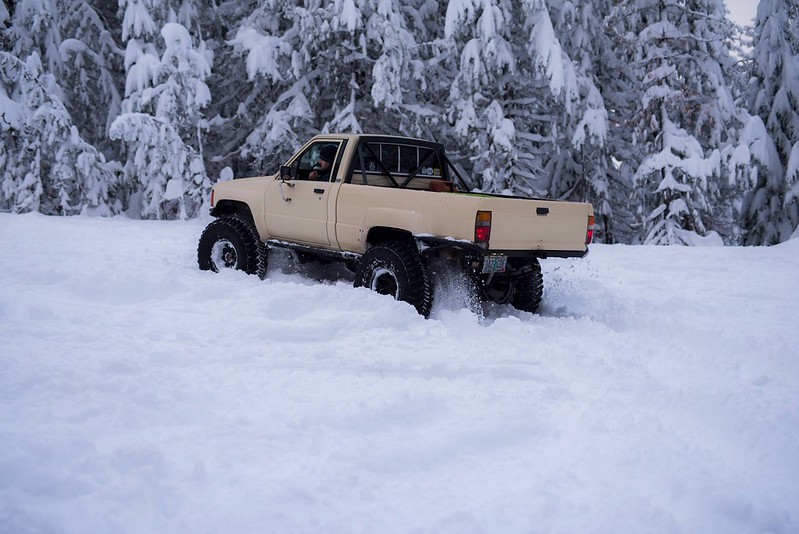

Here are a couple photos from our most recent snow wheelin' trip. I was really impressed with how well it did. It got around a little easier than our truck did
And a couple more stray shots from various trips that have taken us off the pavement
Great pics. How did that pickup ever climb out of that vertical gully in Moab?
Thanks! The pick up was so close to climbing out - I think if we had a front locker or a little longer wheelbase it would have walked right out of it, but in the position we were at the front was taking some hops we weren't comfortable with (we had to drive it back home to Oregon after all) so we just backed out instead.
