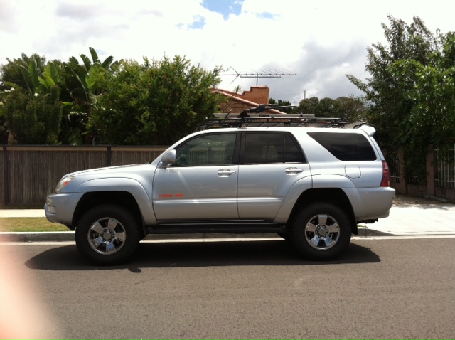

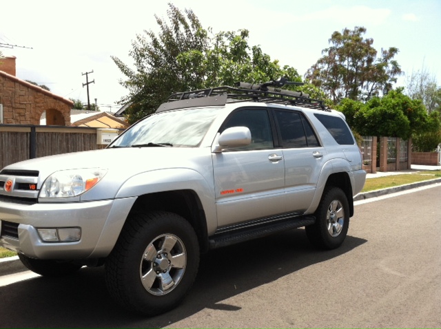

Oh, and since people like pictures, here's my truck with the OME setup on it. (I like orange....)
