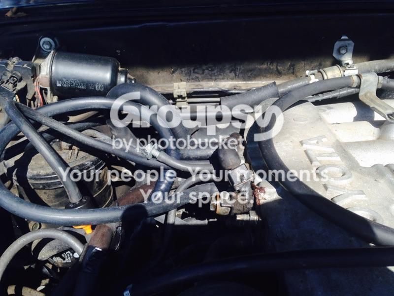

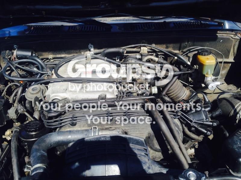

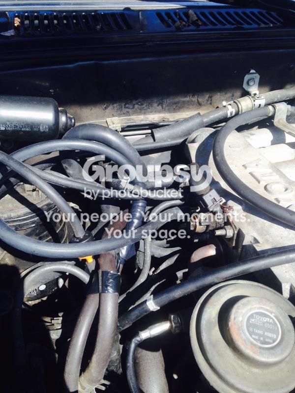

I think i might have a few issues, i have a vacuum line that has no home, instead, it has a screw in it. That could be the issue. I have no clue to where it goes. So...does anyone have any photos of the engine that could help me? I have the 6 cylinder motor. It is a 95 model. Idk how to post photos yet but I will try to get one uploaded of the line. Any help would be greatly appreciated! At least now we are starting to get somewhere! Thank you guys!

There are some pics of the motor. You can see the screw in the one hose. Does anyone know where that hose goes so I can get it fixed?
I just looked at mine, the hose w/ the screw in it, goes over to the passenger fender well and hooks to the underneath side of what LOOKS like a miniature fuel filter, that is mounted on the fender well, right beside the fuse box ( on my 93 p'up w/ same engine) .
