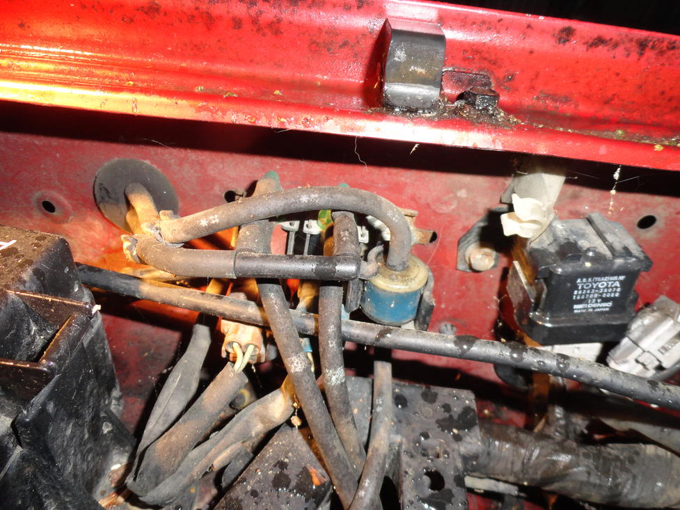

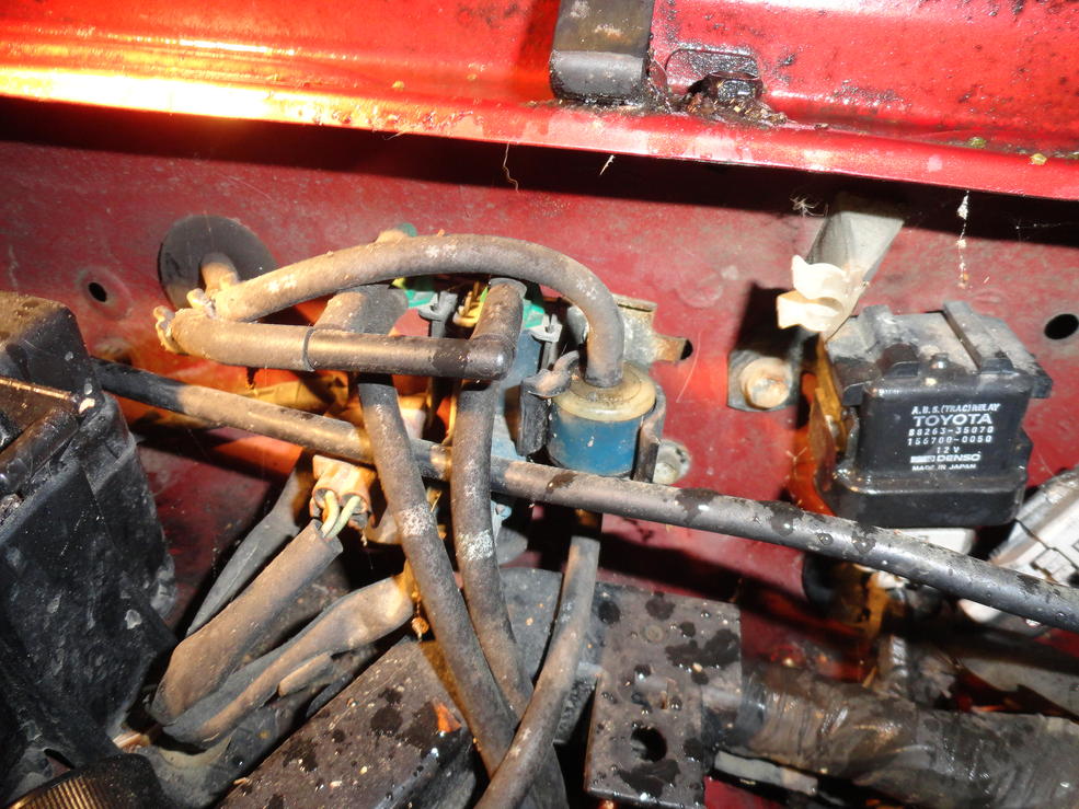

I just looked at mine, the hose w/ the screw in it, goes over to the passenger fender well and hooks to the underneath side of what LOOKS like a miniature fuel filter, that is mounted on the fender well, right beside the fuse box ( on my 93 p'up w/ same engine) .
Is there any way you could upload a photo or send a photo to my email? TJS4RUNNER [MENTION=90914]GMA[/MENTION]IL.COM.
pics

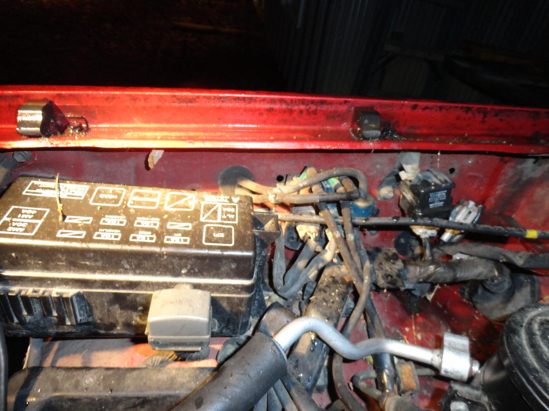

Just got home and it's dark again....i just took 3 pics for you....this is the passenger side , i pulled the camera back on the 3rd pic so you can see where it is in regards to my exterior fuse panel. The a/c line is kinda laying there cause i didn't get a compressor put on when i had the 4runner motor put in my truck years back. And again, keep in mind, this is a 4 runner engine in a toyota pickup....fwiw.
The hose in your pic w/ the screw in it, goes to the bottom of the miniature filter looking thing in my pic ( the small blue thing )
I don't know what it's called, but that's where the hose goes :peep:

Found the issue, i got tired of it and took it to a shop. Turns out the hose with the screw doesn't matter lol. It was the idle control sensor. Runs like a champ now so far =). No more screwy idle at stops and no more stalling.
