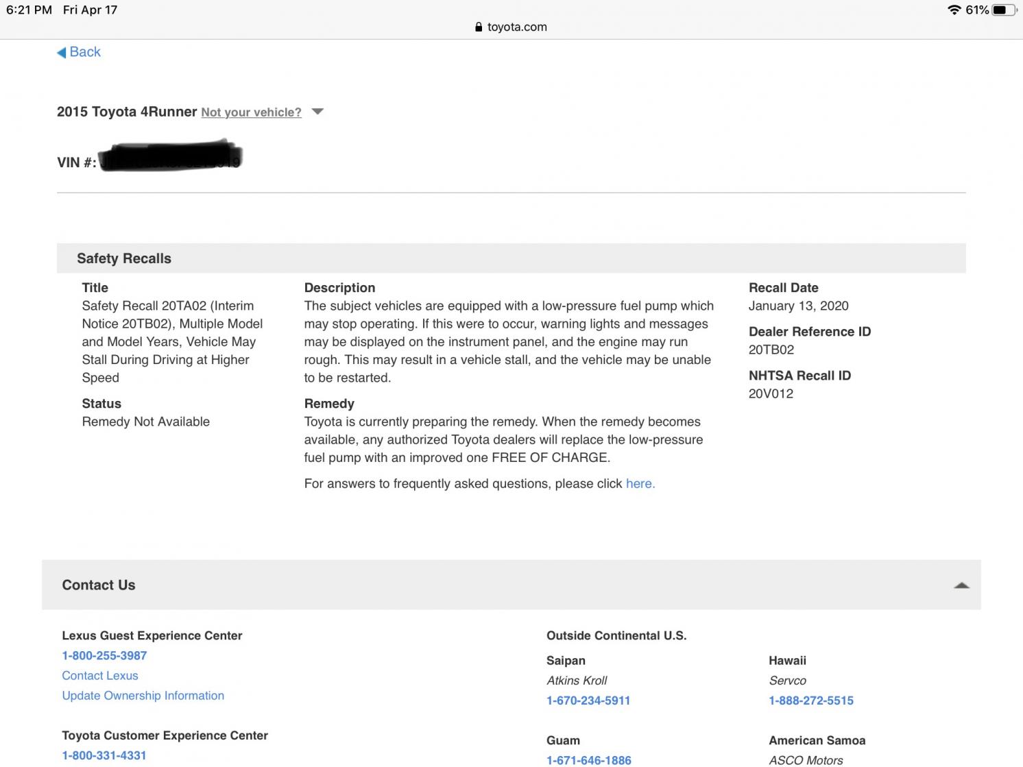

I never received a recall notice for my 2015 TRD Pro on a fuel pump. Is there a way to look up and see whether my VIN was affected?

I looked up my VIN number, and there are no recalls.
I guess it could still be the fuel pump .
When I enter my VIN this is what comes up...
Mine show nothing. But I will cal next week and talk to my service advisor. I've go the Platinum Warranty, so cost won't be an issue. The issue will be thm being able to diagnosis an intermittent problem before i really get stuck somewhere.

What sucks about that recall is they don’t have a remedy yet. So people that have fuel pump failures are probably getting the same fuel pump that fails installed again for the time being until a remedy is available.
