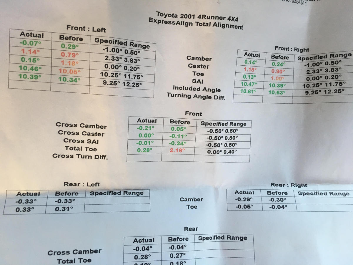

I just got an alignment done at Firestone and was in a hurry so didn't really look at the specs. I figured they would say something if there are any issues. I'm looking again now and it seems like my caster is off quite a bit. Is this a concern? Should I take it back? The rig drives fine and doesn't pull to one side.
I have a 3" lift kit and fresh 265/75/16 (disregard tire size in pic).
All they did was adjust your toe. It should have more caster but may or may not be possible with the lift and stock uca's.
Yep, all they adjusted was the toe. I guess they were in a hurry too. I would tend to not track very well with so little caster. I'd take it back or find a better place.
Lifting is one of the worst things you can do to your truck as far as on-road driveability and handling goes. Without aftermarket UCAs you'll be lucky if you can get your caster within the specified range, luckier if you can keep it there.
But if you think your rig drives fine with 0 caster, then you've got no worries.
0 caster makes for twitchy sensitive steering, and a tendency to wander and require constant steering input.
A good alignment shop was able to get mine to the lower end of spec with a 3 inch lift, but it feels like it's slowly getting worse.
OK, I won't go on my "I hate Firestone" rant again, but they did you a huge disservice, and Caster is just a small part. For me the bigger issue is not pointing out to you that the rear thrust angle is almost .4. Zero would mean the axle is pointed straight ahead, .2 or .1 is acceptable, but 0.4 is quite high. Notice one side of rear toe is extremely positive while the other is extremely negative. My runner has 295K and has .2 to .3 thrust angle, it needs bushings on the rear control arms. Yours probably needs them worst than mine does. I know it's a hassle, but they should be ashamed that they didn't discuss the angles with you, I'd ask for my money back $$. And with only a 3" lift, you should have more Caster than that, it isn't rocket science.

Have them try to get the caster as close as they can. Depending on your location in the country it might not even be possible due to corrosion. If that's the case I would get new LCA bushings and cam bolts along with some aftermarket UCAs and another alignment.

Yep, another "set the toe let it go" alignment.
You should be able to get close to the lower end of the caster spec (1.9) with a 3" lift and still keep the camber within spec because when you adjust caster you adjust camber also. Just make sure the difference left to right(cross camber/caster) is within .5 degrees.

They should beable to get you 1.2-2.0* caster on stock UCA's. Make sure you toe is 0 - .1 and camber is as close to as zero as possible also.
Like stated above you have some off angles in the rear. Since nothing in the rear is adjustable you probably need all the bushing for rear upper and lower control arms.
As others have said... they didn't touch camber/caster. Since you have some camber 'available' to work with, they should have been able to get the caster at least 'closer' to spec - and also TOLD YOU what they could or could not get right. Pretty sad.

UPDATE: Took it back to another Firestone location and the tech said the initial alignment wasn't done correctly. The alignment was not what was specified on the spec sheet above! da fuq?? So the good news they fixed it, but the bad news is they still can't get caster to specified range. :( They said not to worry since it does not effect tire wear whatsoever and both sides are almost equal amount of degrees ( -0.2 and -0.1) and not lopsided.
