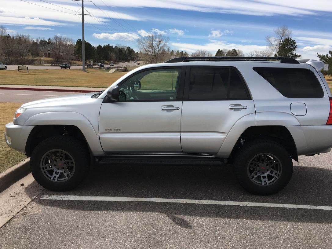

I have FN wheels. They are awesome! Dustin at FN wheels is a great guy too.
