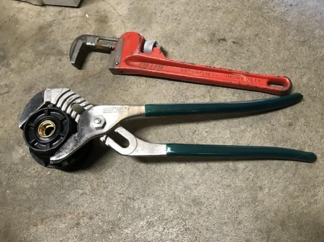

This. Hit the threads with penetrant. But before attacking with a dremel, first try a persuader.
Get large channel lock pliers or a pipe wrench. Pull slowly, the rubber gasket was probably not lubed before installation and it binds. If the cover breaks apart, use the dremel.

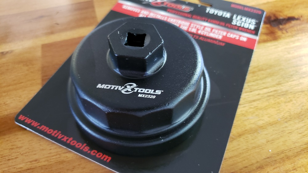

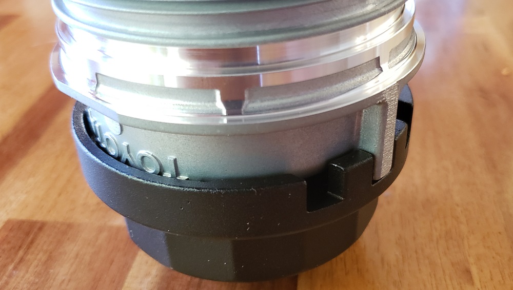

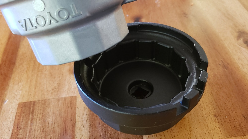

I started doing my own oil changes after the dealer performed the "free" ones. The oil filter housing was very tight when I did the first oil change. I used a cheater pipe on a 1/2 inch breaker bar with a 27 mm socket on a Motiv oil filter wrench, which is a high quality forging. If I had not used the 27mm socket, I think the oil filter wrench could have been damaged by the 1/2 inch square drive. I had a new Toyota aluminum filter housing on hand to install.
Definitely going to try this tomorrow when I'm not so pissed.
