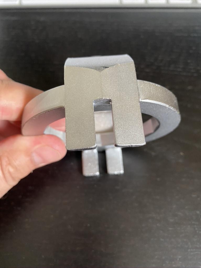

A 27mm Craftsman wrench works well with the MotivX oil filter wrench instead of a socket and breaker bar. Assuming you have the skid plate off. It's ~14.5" long.
This Assenmacher wrench fits completely over the tabs and on the notches.
Its a good design and not some cheap crap made in China that's funding the Red Army like so many wrenches I see people here using that 'eff up the filter housing.
Assenmacher Tool of Boulder, Colorado Toyota Filter Wrench

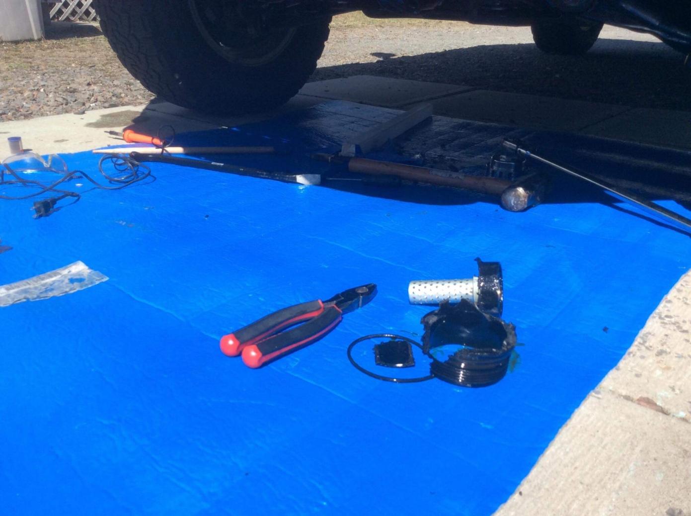

I had mine stuck, the tabs ripped off, and the entire thing tore apart as I tried everything to remove it. The threaded part remained.
In the end, I spent hours with an old soldering iron, melting away at the threaded part so that I wouldn't jack the threads up on the metal part of the engine that receives it.
It was a total nightmare. As you can see in the photo.
Now I have a metal housing, I hand tighten, and I have had no issues
