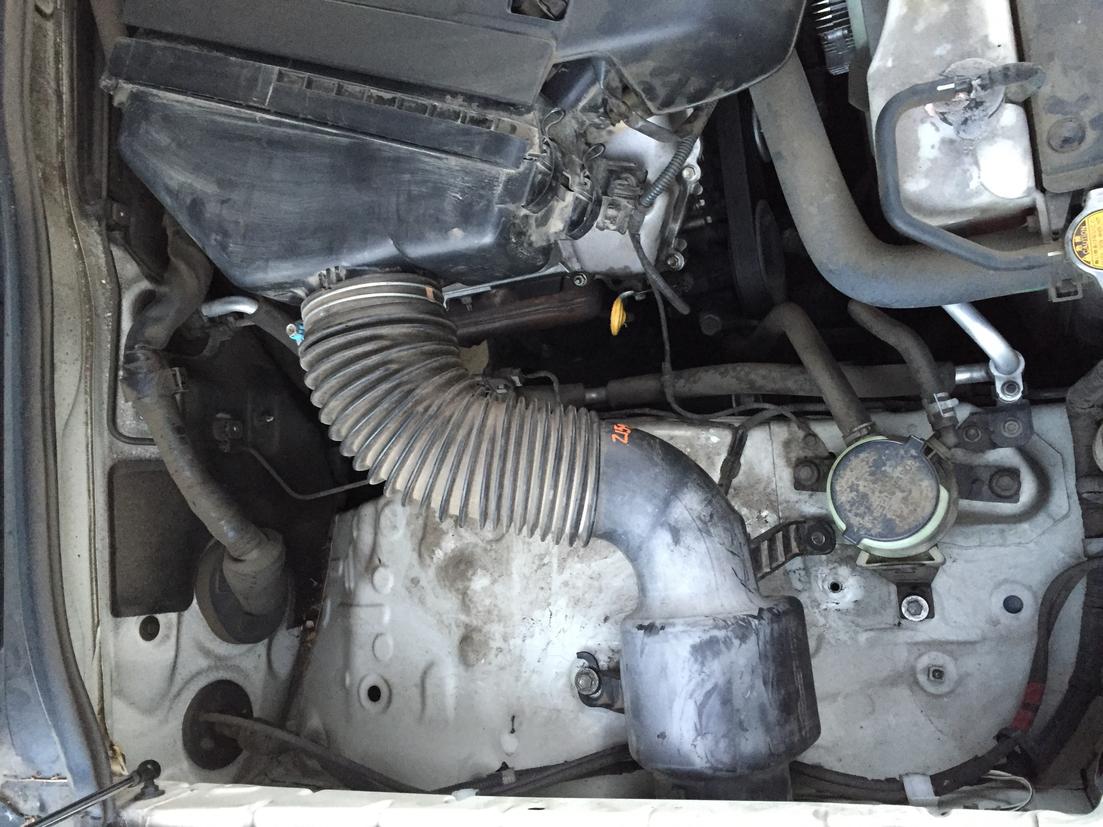

When I bought this car, the previous owner installed some non stock air tube (possibly from a Tacoma?) - see picture
The mounting holes of the airtube are not in the stock location. Therefore the tube was only bolted down to one point since the second bolt hole didn't align. That caused the tube to rattle against the circular cut-out in the inner fender.
I installed the stock 4Runner airtube today which allowed me to fix it by two bolts (2 fixed points) and the rattle is 100% gone.
It's funny but I automatically assumed it was more complicated and totally overlooked this. Replacing this unknown airtube with the stock airtube was on my to-do list for several weeks but not specifically to address the rattle. When I was swapping the tubes today, I thought to myself, "hmmm this tube is pretty loose, could this be my rattle source?" Lol
The rattle sounded like it was coming directly from behind the dash, not in the engine compartment. Sound can really travel through these cars. Time for a beer.
