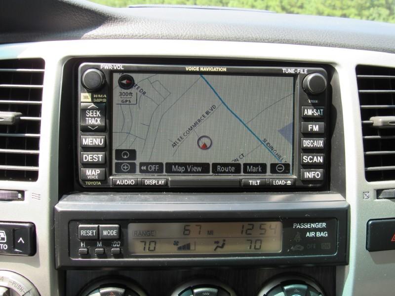

2008 4Runner Limited V8 with option package. Includes Model E7008 JBL Radio with Touch Screen Navigation.
Photo attached of the unit working... before it died.

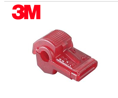

When I opened up the dash, there were many, many taps into the factory wires using those pinkish-red colored taps that provide a 90 degree plug in spade connection. (see attached photo).

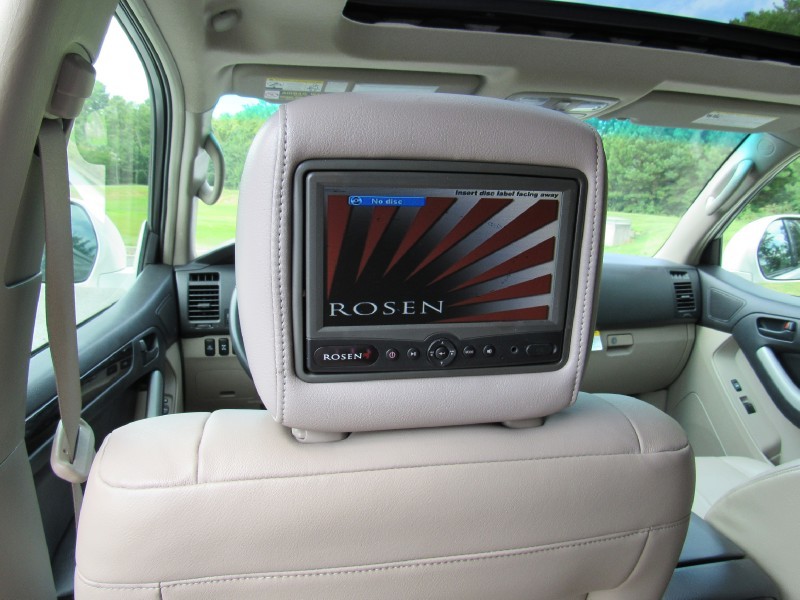

The car has two Rosen aftermarket DVD players in the Rear Headrests.
(Photo also attached).
Many of those taps are no doubt to integrate the back seat DVD players in with the factory system.
My concern is that some of those taps may have created a small break in one of the important factory wires. I know that they pierce and squeeze the wire they connect to, so it may be possible that one of the wires is broken at the location of the tap, and that could be the cause of the problem.

I would suspect the wire taps as well. I never use those, I like to solder everything.

The root cause was one of the taps was loose. It was connected to two relays, and because it was loose it caused the relays to cycle on and off intermitently and frequently. The relays also didn't have a diode attached to them. For those who don't know, when a relay is disconnected, it can cause a huge voltage spike. You can and should wire in a diode between two of the terminals to allow this spike to safely discharge.
So the short cycling of the relays caused by the loose wire tap caused the ACC fuse to blow.

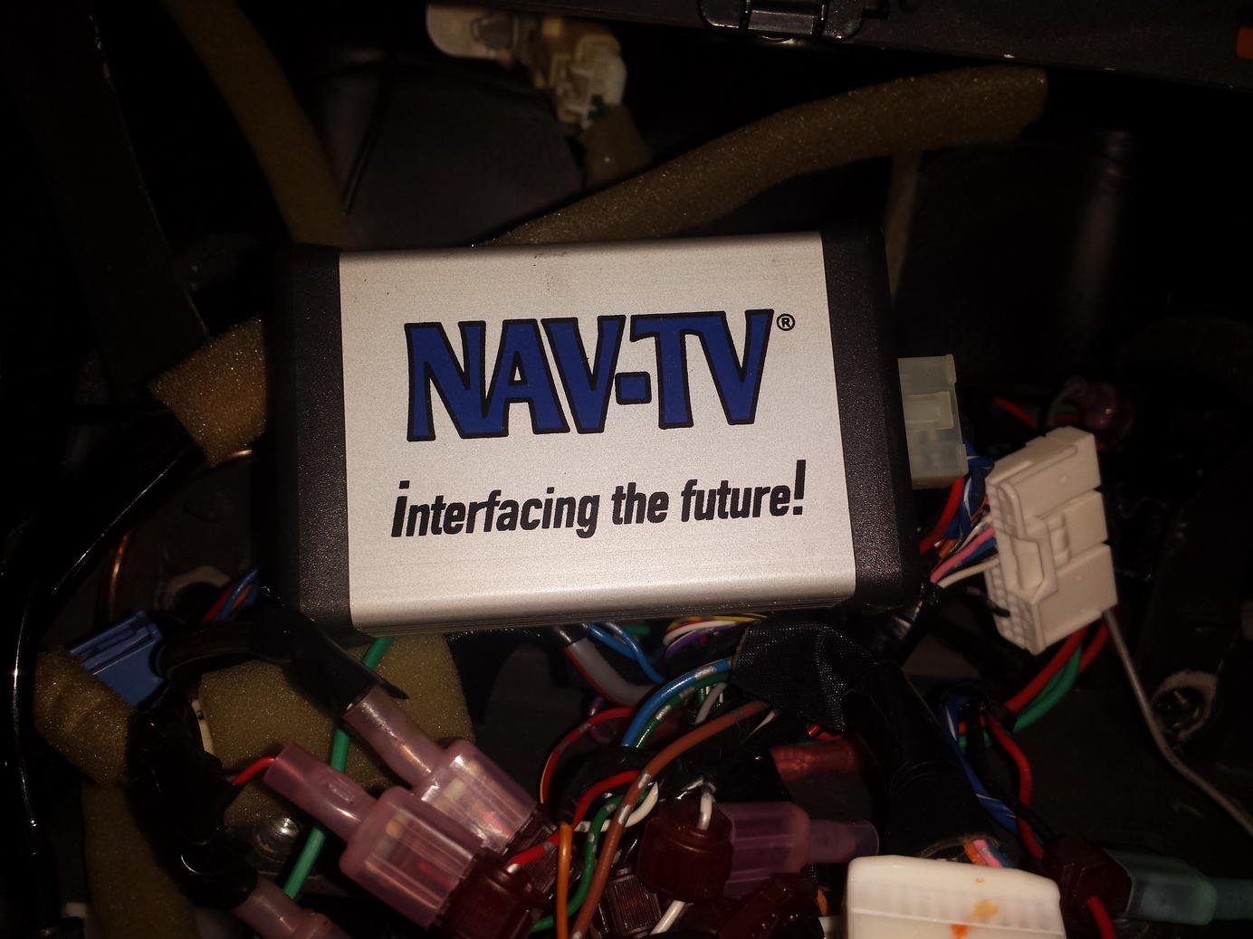

It came with the truck. I'm still trying to figure out exactly what it does.
IIRC, it has two power wires, and two signal wires. I would have to look to see if it has anything else.
Can you tell me what it does? I found that I can play a DVD in the headrest and watch the movie on my Nav unit and hear the sound through my factory JBL system. The picture and sound are awesome... while the engine isn't running.
When the engine runs, there is lots of noise, but that's the fault of the the installer. When I have a chance, I'll clean up the wiring and especially the grounding, and maybe add some shielding, and everything should be fine.
-Phil
