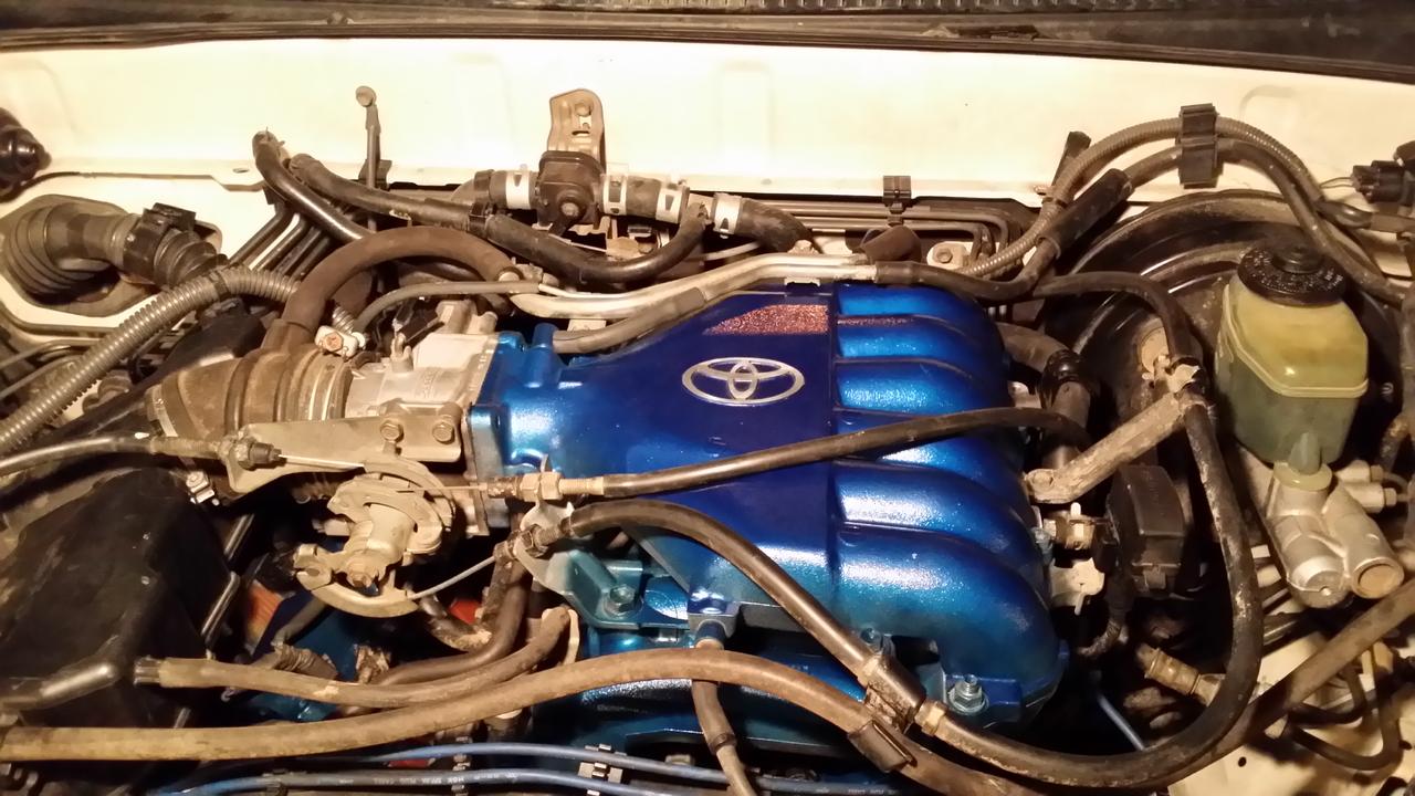

All back together with a little extra to look at under the hood.
Only thing that seems to be an issue on test drive was no temp. Guage for some reason. It's not moving at all. I'll have to look into that pretty quick

[MENTION=92510]Ol'Blue[/MENTION]
Back of the block.
The single wire that is a ***** to get out because its so fragile.
Back of the block.
Great! FML.... I did notice that there was a wire pulled out when I was putting it back together. It was late and I was like F it.... Now I know what and were it is at least. That is not going to be easy. Hell the clip didn't want to come off at all either.
:tsk:
:tsk:
Yeah. Its one of those things where if you don't know to llook for it, it's easy to break.
That clip and wire are retardedly stupid PITAs. if you pull the wire out, there really isn't anything you can do unless splicing a piece in there, and adding a new plug.
Oh no, I'll get it out one way or another and reuse it. The wire pulled out of the fitting.I will have to open it up but I will have to re wire it in and maybe put some heat to it to make sure the wire stays in place.
