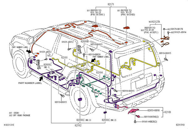

[MENTION=18304]pearlj10[/MENTION]: Well, for laughs, I looked up OEM harnesses for an '06, and to my dismay, it appears that the Runner has three MAJOR harnesses that run from firewall to the back of the vehicle. One on the driver side, one on the passenger side and one along the cieling.
As you can see, the two floor harness' includes many, MANY connection points for different components of the vehicle, power seats included. And new, they run around $700.00 per side. At this point (assuming that you are not willing to drop $1,400.00 for new harnesses), your only choices are A) hit a junk yard and yank some connectors from a salvage to splice into existing harness or seats, B) attempt to fabricate your own, or C) sell the seats on Craigslist. Sorry about that.

[MENTION=83135]bamma[/MENTION],
Er, yes, that was exactly the point that I was trying to make. He has an '03 yet requires harness connectors to match '06 seats. The schematic I posted was for a 2006 Runner so that he could see what that year vehicle has.
