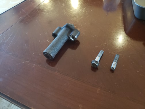

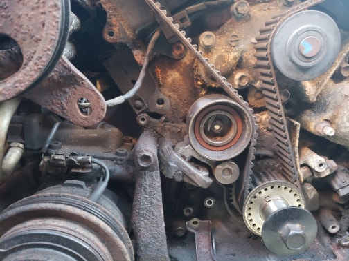

Update: Mechanic was able to somehow cut the head of the bolt and get the rest of it out. Tomorrow have to just pull out the actual bearing piece of the tensioner assembly and all should be well. Going to go to a hardware store and see if they can match a new bolt. Will update tomorrow.
