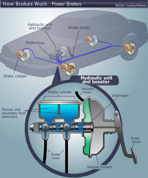

OP: If you want to test your booster just to rule it out then do the following:
1) With the 4runner turned off, pump the brake pedal until you feel it get firm.
2) Keeping your foot on the brake pedal turn the truck on.
3) If the pedal goes to the floor then the booster is doing its job. If the pedal doesn't move or doesn't move much then your booster is bad.
The function of the booster is to provide vacuum assist to the master cylinder for power assisted brakes.
The master cylinder takes that assist and pushes an internal plunger to provide pressure through the lines and to the calipers.
