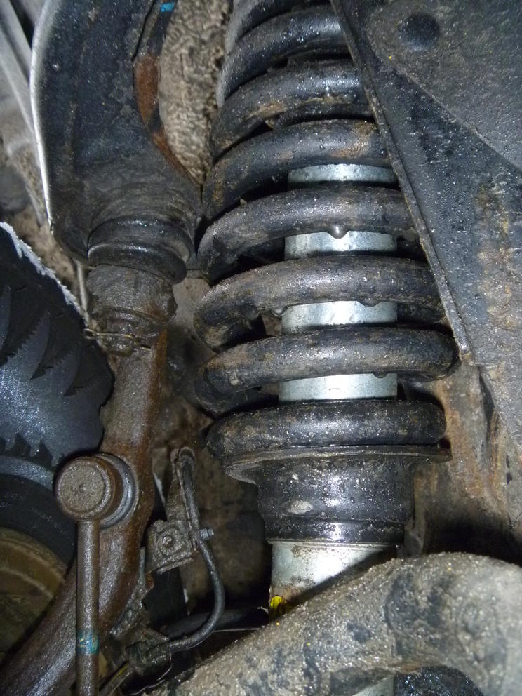

This is upside down
56595d1327343990-starting-freak-out-loose-front-end-p1030999-jpg
This is right side up
Yep , probably those spring seats are upside down... Looks like the kid who does oil changes got promoted a little early...

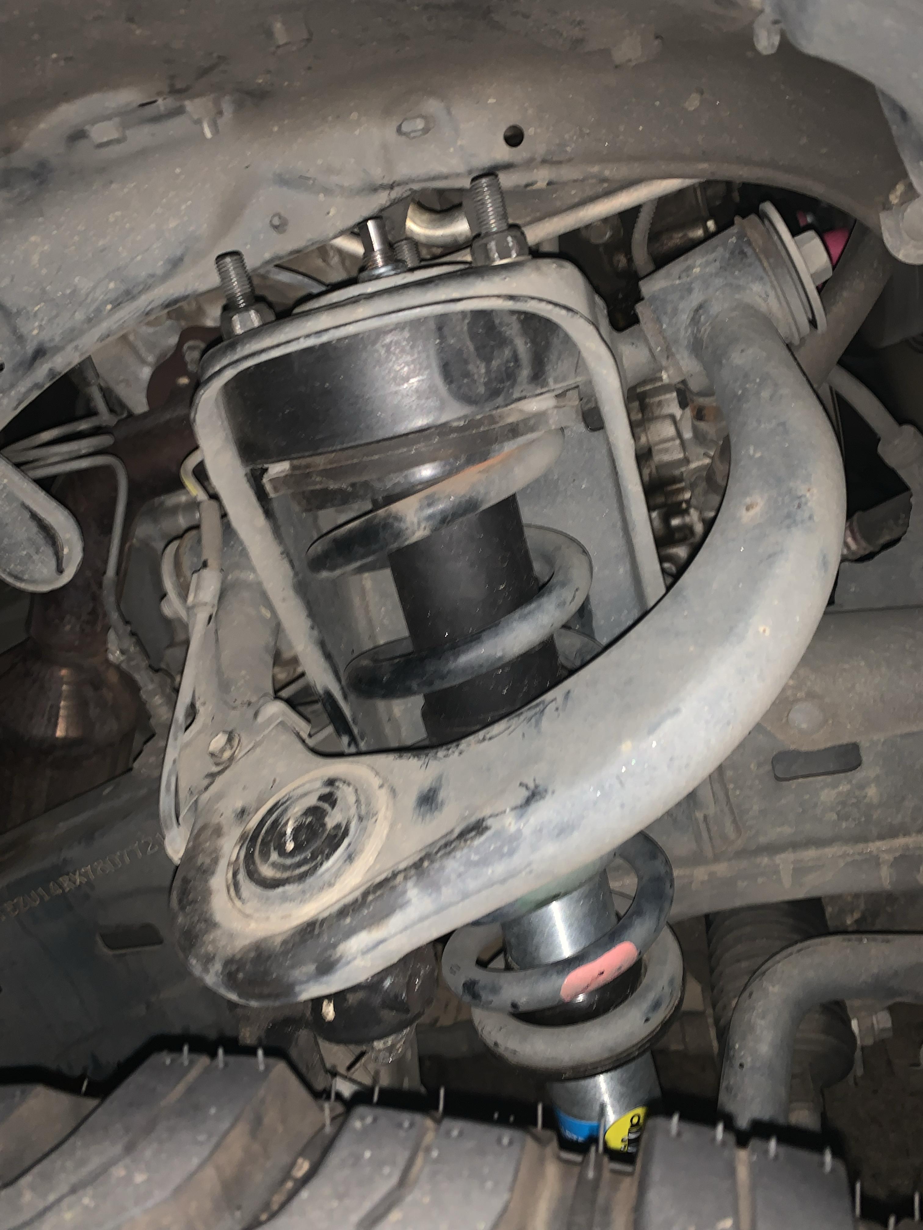

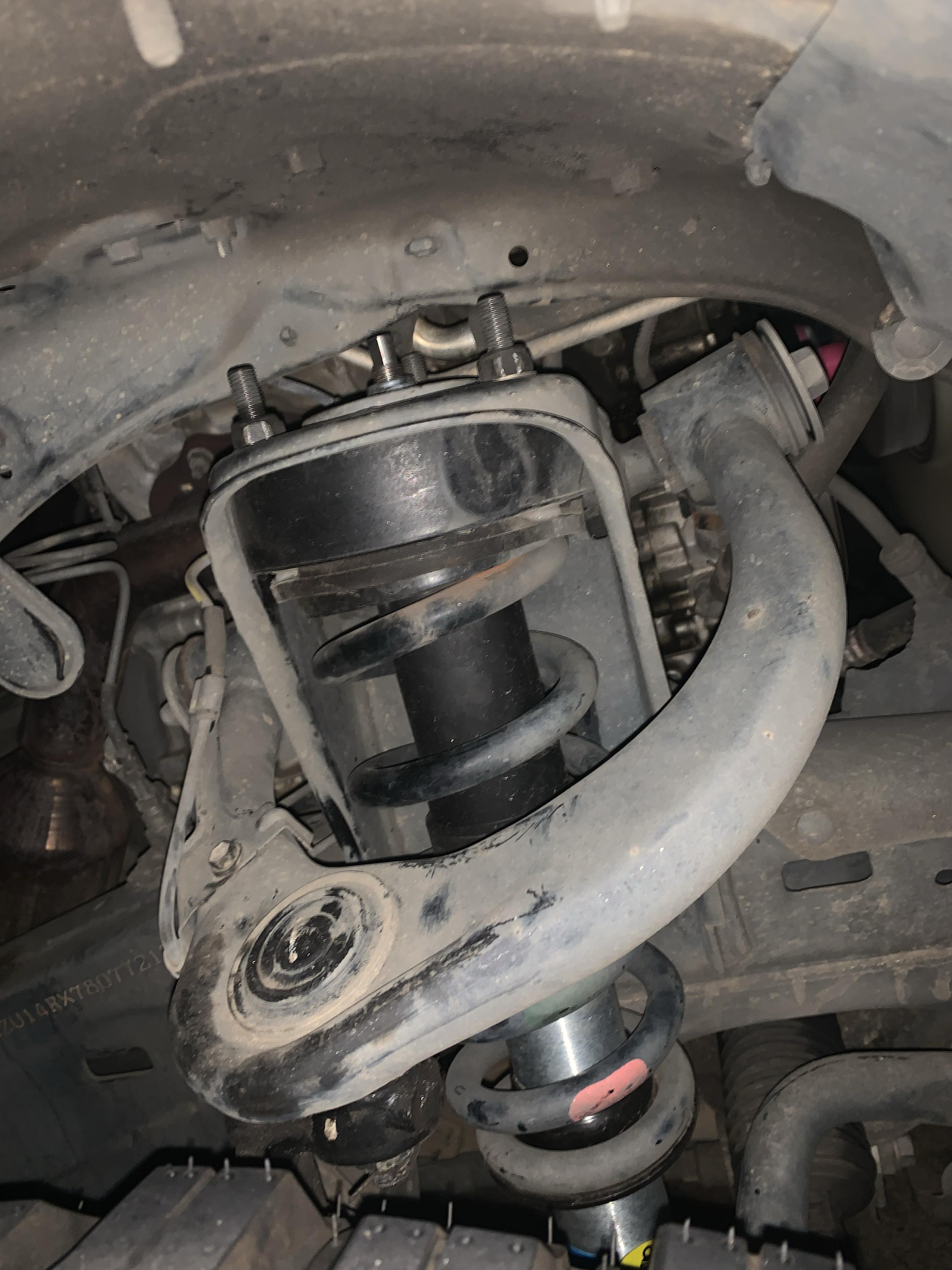

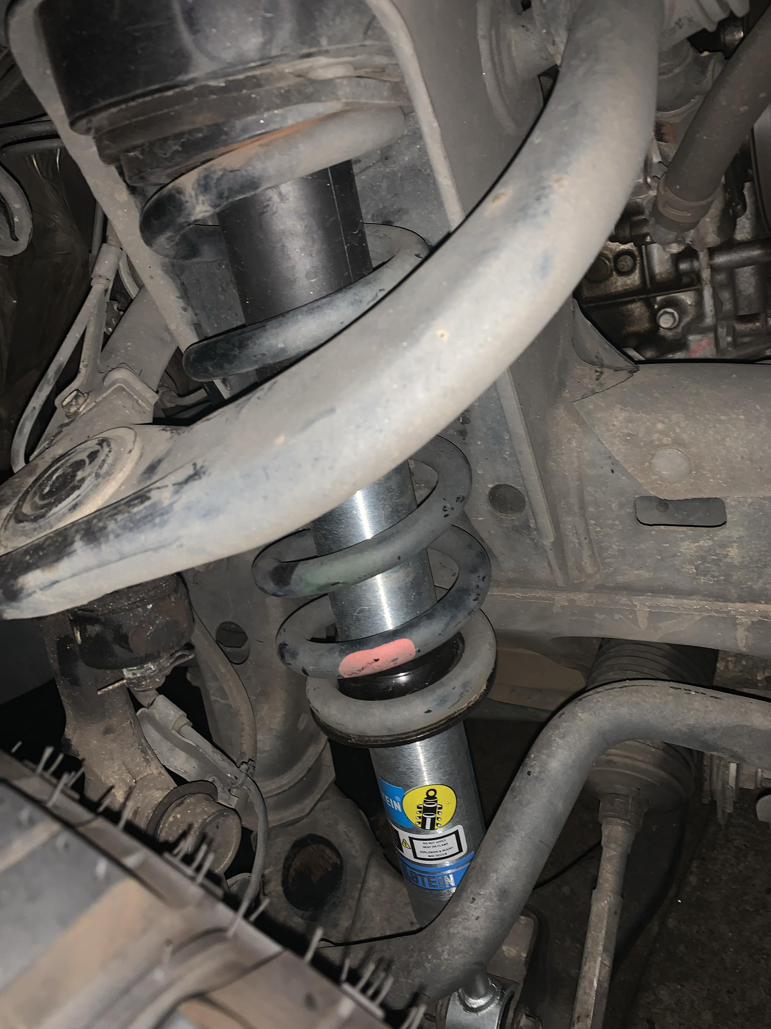

Unfortunately, it looks like my spring perches were installed correctly.
I am seeing that the Daystar lift spacers are indeed retained (and I never asked for those to be removed). But that should not affect the ride height considering my 4Runner was level prior to the Bilstein 5100 installation and the struts are set at 0”… right?
Hmm, might need to double-check they're actually set at 0" - I think you should be able to see the additional notches above the 0 setting, but dont see any above that lower perch, so it might actually be set for max lift. Picture angle seems to obscure it a bit, so its hard to tell from those pics.

jcaino nailed it, looks like you're set on the highest notch (I'm set to 0 and can see additional notches above the perch).
You'll need to remove them in order to adjust the height setting, unfortunately. Hopefully the mistake was on the mechanic's end and they'll make it right.
As stated, there should be I think 2 notches in the shock body visible above the perch. It doesn’t look like there is. So take it back and have it set to “0” or remove the spacers and see where that leaves you.
OP, here are the 5100's installation instructions to help you visualize what's happening. As has been mentioned, the strut will need to be disassembled to change the height. A C-clip is placed into one of the four grooves and the lower spring perch sits on that clip. Spring pressure has to be removed to release the lower perch to expose the C-clip.
