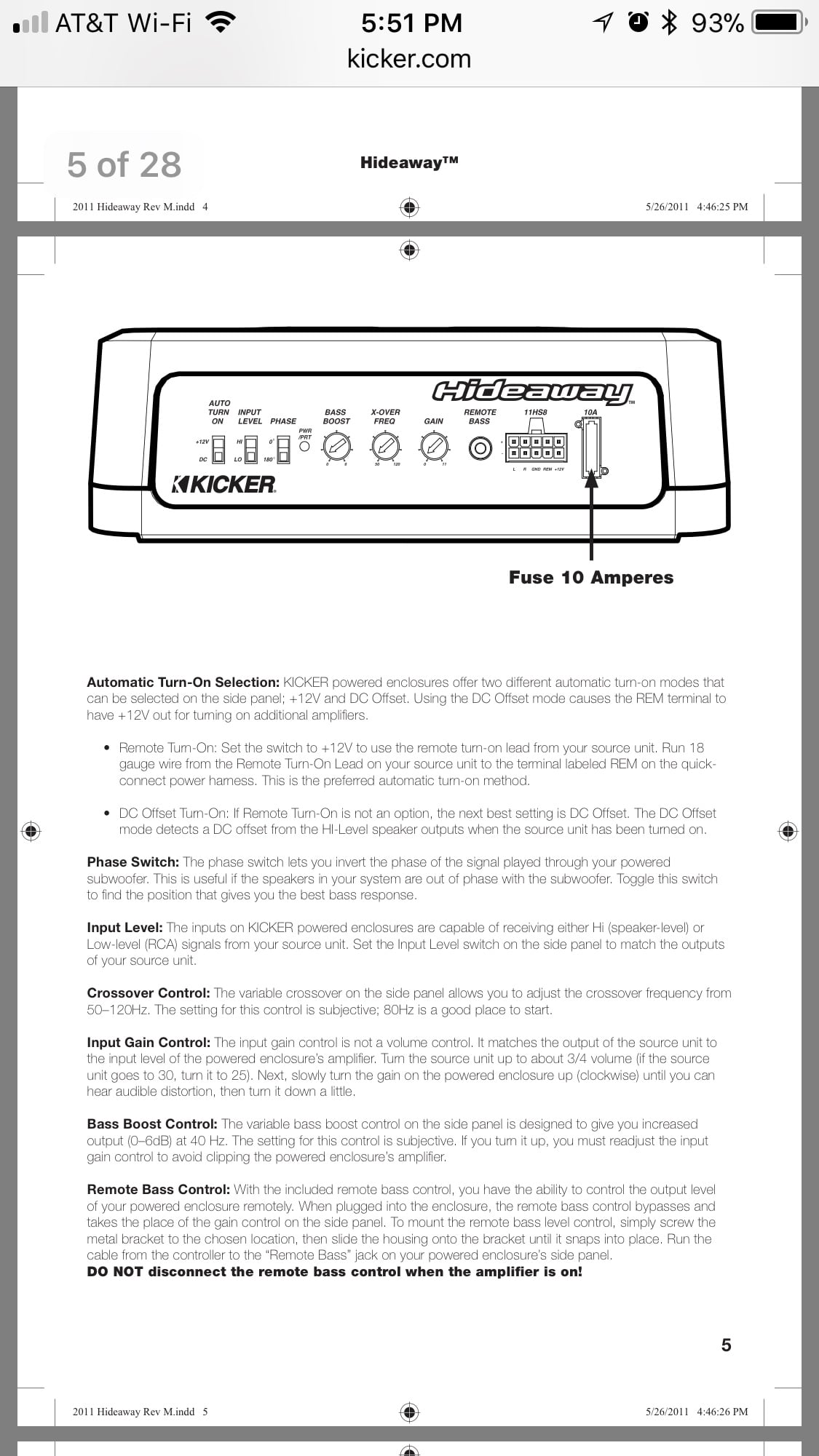

I’m guessing it’s not in dc mode

Dobie T4R. I now feel like a complete dumb ass. I must of read that twice and still didn't pick up on it. But I could have sworn I switched it to DC and it still didn't work.
