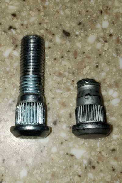

So, the kid wanted me to take him off roading. I have a 2019 4unner with less than 5000 miles on it. Got a flat (kinda expected with street tires).
Anyways, when replacing the spare I hand tighten the lug for about 5 turns and it became stuck....i then had issues backing it out which then broke the stud :(
Either way, trying to replace the stud, but is there a trick to lining up the teeth? for some reason it seemed hard so i just stopped, tapped out the new stud before making this worse.
You can see in the picture the teeth in the new stud were getting stripped. any advice?

Where did you get the replacement stud from?it looks larger diameter on the splined portion
You know what, I thought the same thing so i just went out and measured. the new stud is larger. I got it from oreillys. they said its for a 2018 4runner which i assumed would be the same.

I snapped a stud changing rotors once. The front studs are different than the rear studs!!!!!!!!!
I ended up getting them from the neighborhood NAPA, 2 of each front and rear.
The old stud should tap out fairly easily and the new stud should tap in easily.
From your pic, it looks like the wrong stud.
Maybe you crossthreaded the stud when it broke and the lug is boogered now....get a new one when you are there.

I literally just got it fixed by the dealer about 5 hours ago. They covered it under warranty. The issue was I could not find the part anywhere. Oreilly and autozone had ones for the 2018 4runner which did not fit the 2019.
For anyone that needs it or for future reference. The part number on the invoice is 90942-02079 for the bolt/hub and 90942-01058 for the nut/hub/washer.
Let's correct the record for posterity to avoid any future misunderstanding:
The wheel studs are the same for all 5th generation years, most 4th gen., and all years of the FJ Cruiser.
The front and rear studs are different.
The rear studs are Toyota #90942-01058 or Dorman #610-462
Front studs are Toyota #90942-02049 or Dorman #610-266

the picture in my first post is of Dorman #610-462... it did not fit.
