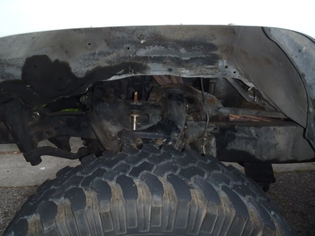

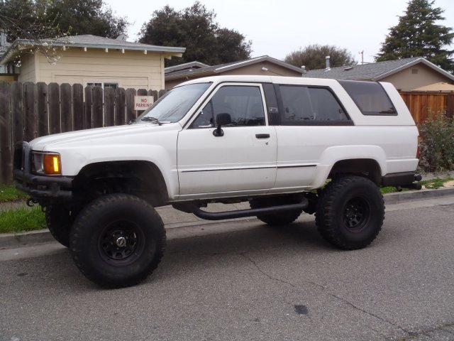

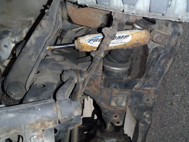

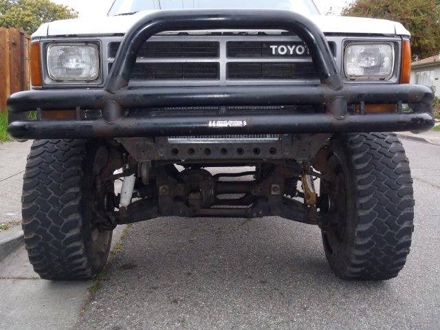

Looks like your standard 4" bracket lift, like this > http://www.roughcountry.com/toyota_4wd_86-96_5.html
The only way to bring it back to stock height is to remove all the lift components. Unfortunately youll need to find some stock parts, such as spindles and shocks.
How is the rear lifted? Are there blocks between the axle and the spring?

Like others said, it looks like a 4" bracket lift. You can probabably just turn down your torsion bars. You may even like the ride better after that.
