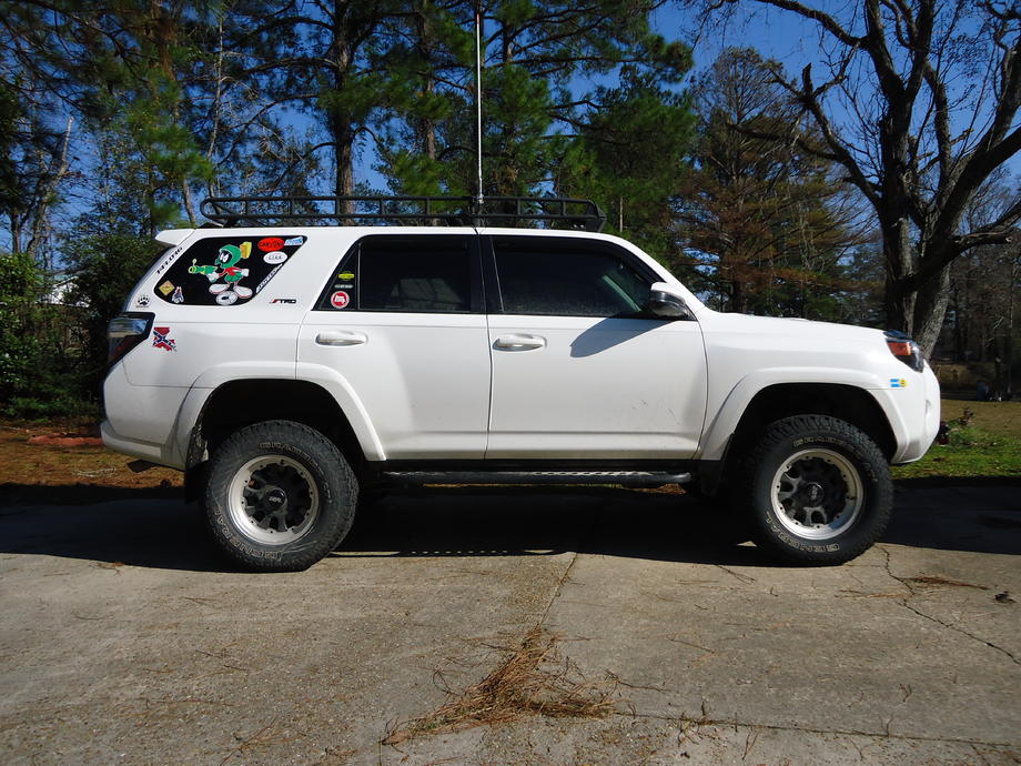

This is 2.5 / 1.5 with 285 tires.

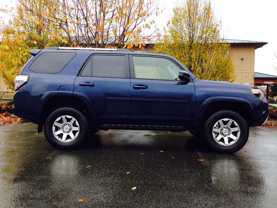

My TE with Bilstein @ 1.75, 1" cornfed spacer, stock springs, stock UCA's. Rides & looks good IMO.
