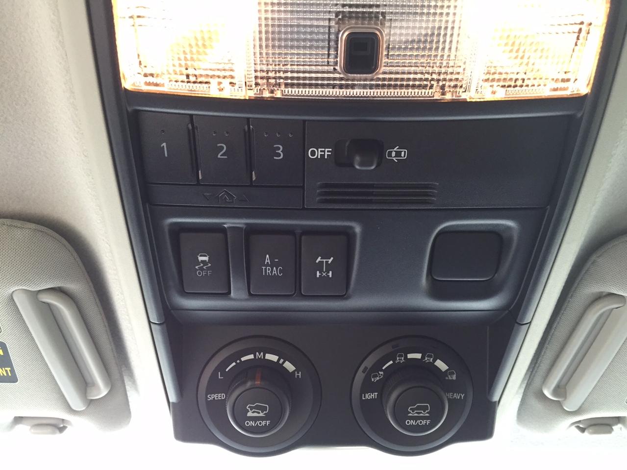

I just picked up my 2015 super white T4R Trail and wasn't sure if it came with homelink installed in the upper console. It turns out there are 3 versions of the upper console for the trail. See attached pics.
I'd like the one with the homelink buttons and the light control button but not the sunroof controls (as I don't have a sunroof).
1. How do I source this panel? Neither I nor my local parts guy can find it?
2. Will it work? Does anybody have this panel in their truck?
Thanks for the help!
In the pictures below, the first one is what I have. The second one is what I want. And the third one is the version with the sunroof controls, I don't want that one either.

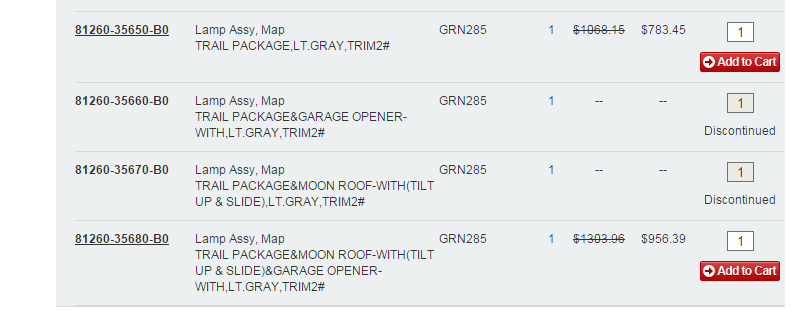

If you can supply with the VIN of an American vehicle that has the console you want I can give you the exact part number out of the catalog.
See attachment. It appears only 2 versions are available for purchase. One with everything including homelink and moonroof(like picture 3) and one with nothing(like picture 1). The other 2 versions are discontinued.

Yep, I agree. The trdp is a TEP without the sunroof. And I think the the 2nd console pic in the OP is probably a trdp. I never noticed that blank on mine until this thread. I wonder what a PITA it is to remove the headliner enough to run a button fro rack lights. I'll have to check that out. I'm ordering the bajarack flat utility rack with the spy light system this afternoon.

My local dealer parts guy claims I can only buy the whole upper console and it costs almost 1K!!!!! Maybe I'll find an elusive totaled pro...
