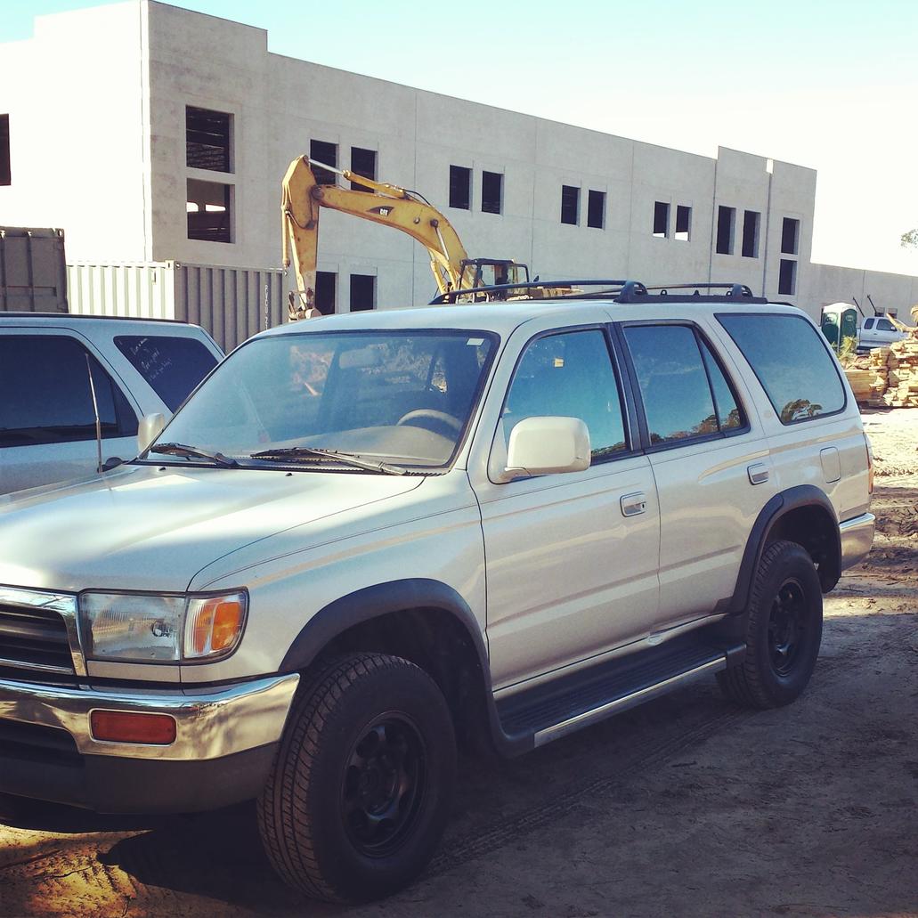

Hey guys I bought a 97 V6 4runner last sunday. Got a hell of a deal on it cuz it runs a little rough. Took it to advanced today to get CEL checked. Came back with 10 codes. All have to do with miss fires or the cat... got one for every cylinder and random. Any ideas where to start. Looking for a solution for this problem? Thanks in advanced
