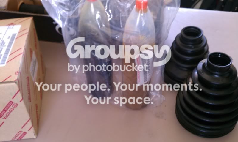

I think Toyota's OEM CV grease is that yellow color, but generally it turns grey/black pretty quick.
I'm grasping here, but maybe they yanked the joints apart, tore the inner boots, rebooted them with new grease, and didn't clamp them properly. Not sure how you would manage to do that to both sides
ETA: Just found a Toyota OEM boot kit on this very site

http://www.toyota-4runner.org/4th-gen-t4rs/113758-toyota-cv-grease.html
Interesting it looks like Toyota calls for the typical molly black grease on the outboard CV/birfield.. and the yellow grease on the inboard tulip I did not realize they specified two different types of grease. Very strange, but good to know and it sort of makes a little more sense after seeing that.
Still don't understand how both inner boots ripped or failed here. It would take some real effort to do that simultaneously... Nothing holds the inboard tulip in place... If you pull hard enough you can rip the boot, but how could someone do that during lift install.
