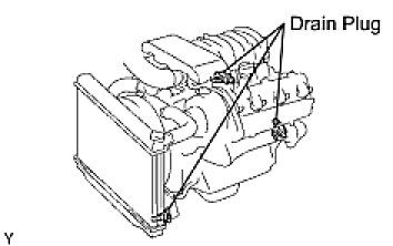

Supposedly there are 2 drain plugs for the V6. To properly do a flush you should remove the engine coolant drain plug.
When I did my flush I had the vehicle up on the lift and I could not locate the drain on the engine block. I could not even get a visual on it either. Took out the skid plate, etc. The alternater and other things are in the way.
Anyone able to located the cooland drain plug for the V6??
Engine block drain plug for a V6 is on the passenger side engine block just below the exhaust manifold. If you look through the front passenger wheel well you can see it. It's a nut next to a little drain spout.
