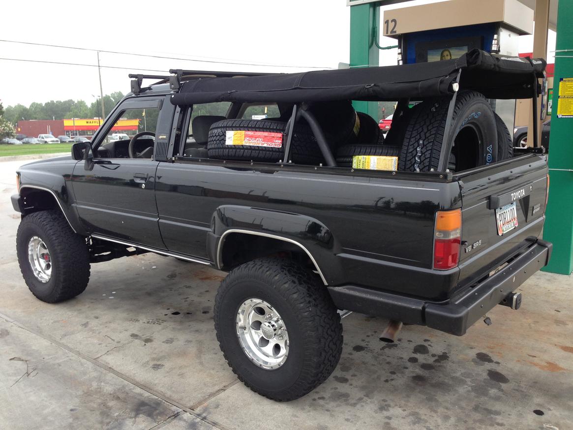

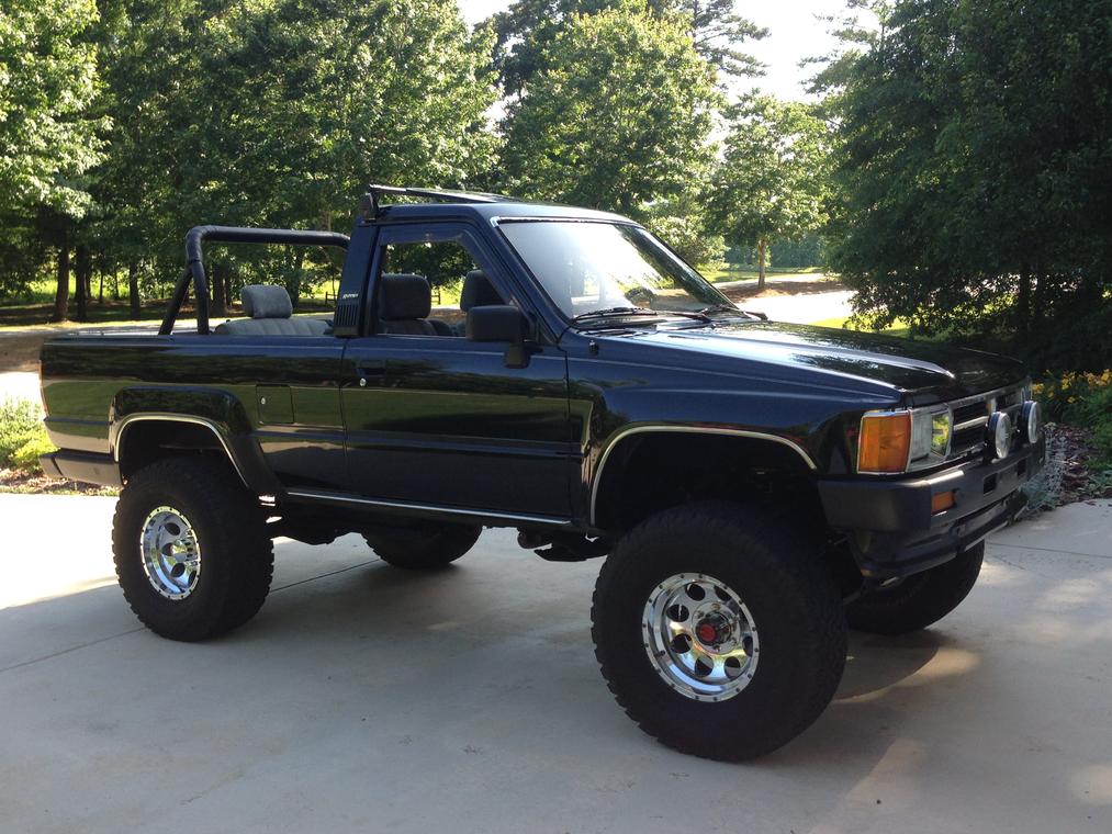

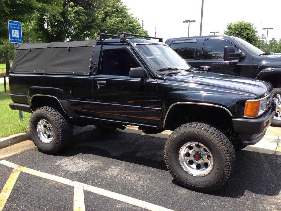

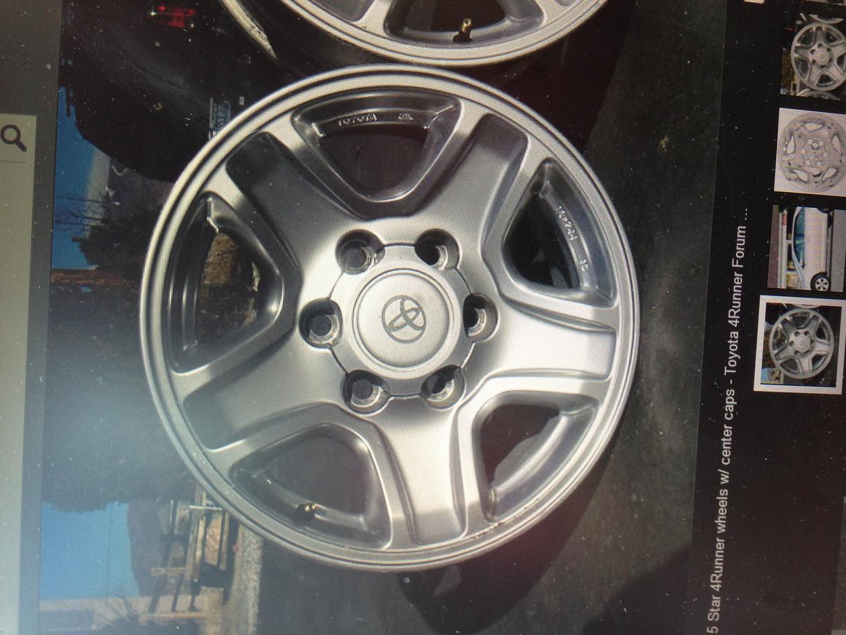

I am looking to see if anyone has ever put the factory Toyota 5 Star wheels on a 1st gen 4Runner. I have a set of 33/12.5/15 now. Thinking about going to a 285/70/16. Just would love to see what it woukld look like. I have searched the internet with no luck. Any help would be great. Thanks
Are you talking about the 3rd gen 5stars? I'm pretty sure they're the same width and backspace as the split 3spokes, and I run those on my first gen. I need spacers to fit them on my straight axle or they interfere with the tie rod ends. I had no trouble fitting them on the IFS '86 though.
