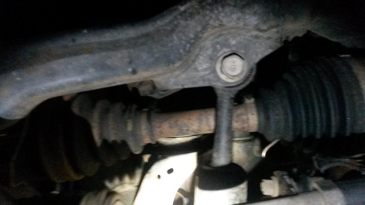

Hey all, got the lift installed and all was well. I got the alignment today then when I got home I was going to put the skid plates back on and climbed under the car but the got side tracked. The wife drive down the road to pick up the little guy and came back home. Now I club under and I see this gray geese around the end of the cv boots like. What do I do? It's a Daystar 2.5/1.5 kit. The alignment shop didn't say anything. We are supposed to go to the mountains in two weeks on a honey moon and now I'm freaking out because of this!!
Don't worry, this is very common when you lift the truck because of the change in CV angles. It likely just needs to be re-clamped which can be done with a hose clamp from an auto parts store. If the boot is torn, you can either replace the axle or reboot it.
I was under the impression that rebooting an inner boot requires you to completely remove the axle. Is that correct?
It looks like the boot got pulled off the ridge on the shaft. just try to seat then back on there. How bad are the cv's leaking?
Mine leaked a little after I installed my ds lift, because they pulled off. But I wiped them off and shot some more grease in there and they've been fine ever since.
Mcmaster care sells clamps with rounded edge clamps for silicone hoses. If the boots are not torn use these for a long term fix. ( quick shipping, check toyota120 for the p/n's). In the short term for the honeymoon, clean them up and use a new clamp and figure it out after the honeymoon. First things first, ya know what I'm saying'!!!
This is what it should look like when seated. Edit: I'm not sure why the picture is upside down. The right is the wheel side and the left is the diff side

Just found the toyota120 thread. Thanks for the help guys. It's been one thing after another lately. The wife is already in panic mode alpha and I don't know how much more i can take before I hit freak out mode. This was about to be the icing on the cake but you guys brought me back down hahaha thanks a lot for all the quick responses I will have this done tomorrow. I gotta get under there anyway.

My 4runner did this when I lifted it also. Try to find some narrow hose clamps to use. IIRC, some of the hardware stores carry a slightly narrower clamp than the auto parts stores. The narrower clamp fits a little better.

Thanks again guy. I called the napa here and they have a silicon hose clamp I'm the size I need. He said it has rolled edges so it doesn't cut into whatever it's on. Sounds like what I need so I'm picking them up today as soon as they come in. Should I try to put some more grease in them?
Any suggestion on the best way to do that? The thread on toyota120 seemed like he had a hard time with the syringe

they haven't thrown enough out to cause an issue.
slap the clamp on there, it will be fine.
