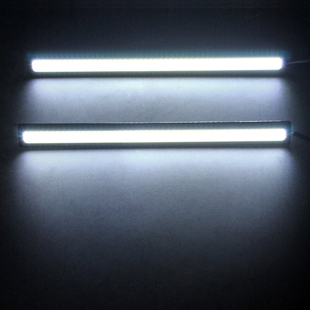

I bought a couple of pairs of these off of Amazon for like $8.00 per pair. They are designed to be DRLs but I stuck 2 to the bottom of each running board for some additional light. They work great. The factory wiring is about half way down the truck and the wires are red and white. Red is hot (always hot) and white is ground. The ground is activated when the lights are to come on. I will take some pictures when I get a chance.

Amazon.com: RioRand 2 pcs Set Waterproof Aluminum High Power 6W 6000K Xenon White Slim COB LED DRL Daylight Driving Daytime Running Light Lamp For Car SUV Sedan Coupe Vehicle: Automotive
Those are really cool. I was actually thinking about mounting some more Eagle Eye lights along the underside facing down but that would mean making more mounts. I think the light you have would work better for that application. They are all over eBay for like $6 a pair with free shipping. They might be coming from Hong Kong but that is a deal.

[MENTION=86829]Bama_Runner[/MENTION] I'd love to see the light output when you get a chance to post pics. My only concern would be if the adhesive failed.
