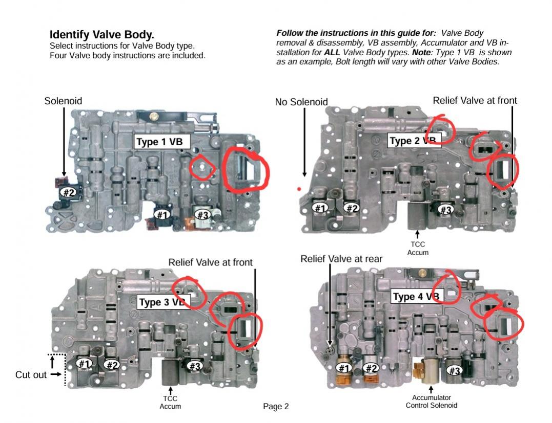

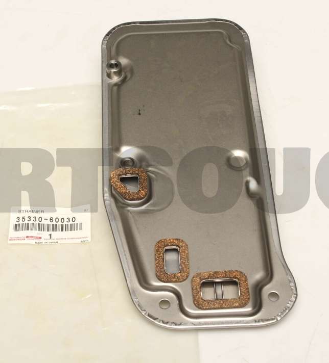

Ok I dug a bit and here is what I found.
Valve body type 1 has 2 fluid ports on the strainer or 35330-60020 part #.
Valve body type 2, 3, 4 have 3 fluid ports on the strainer 35330-60030 part #.
So until you drop the strainer or id the valve body type you won't know. Hate to say it, but probably will need to buy both and return the one you don't use.
First pic are the 4 types of valve bodies the a340 has, circled in red are the strainer fluid ports.

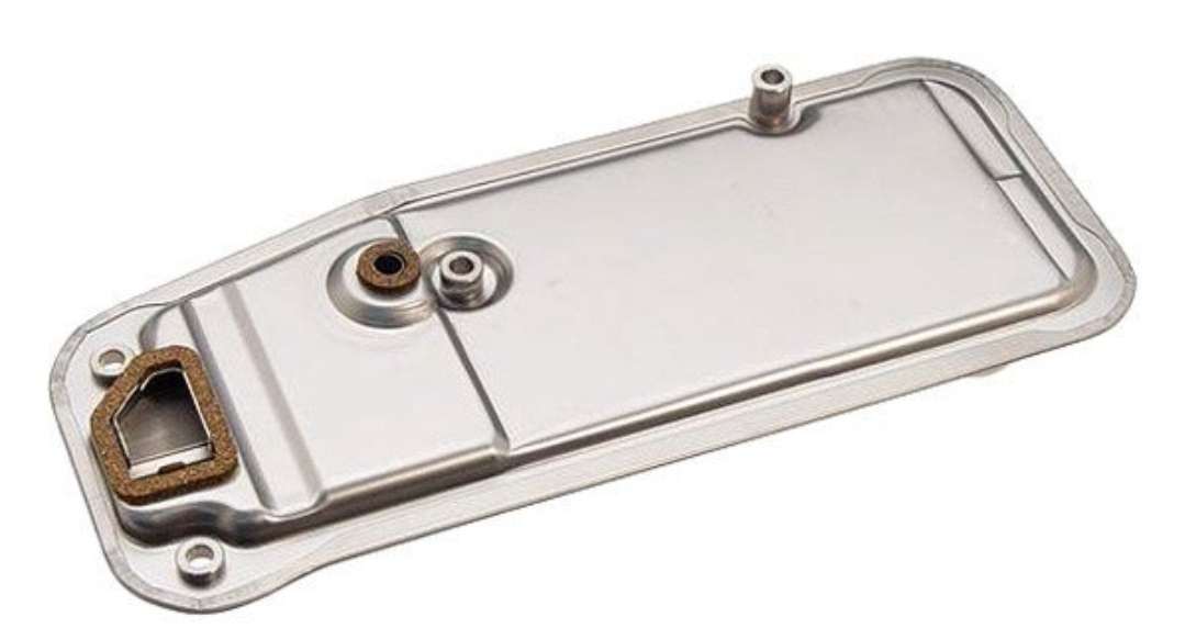

Second pic is of 35330-60020 part number.
Third pic is of 35330-60030 part number.

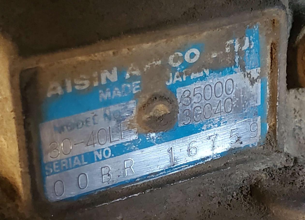

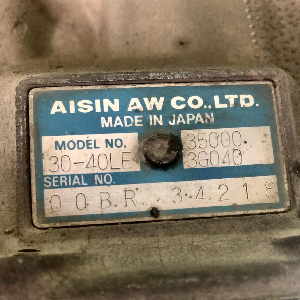

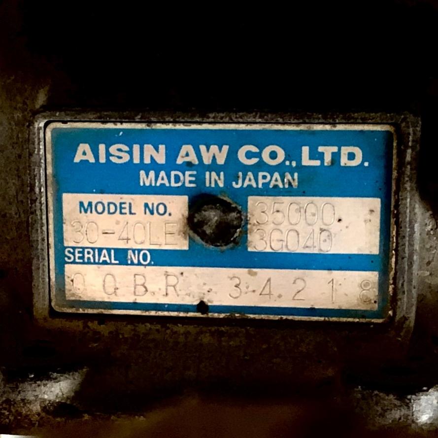

That's some great information and I was hoping the S/N tag on my tranny would solve the valve body type puzzle. It's probably encoded in there somewhere but I'm not seeing it at first glance. I will post which strainer fits ny tag and maybe we can make some correlation with other people's tags/strainer type in the future. The '30' in the Model Number would be too easy, right? Thanks again for posting that info

My tag is: Mod. 30-40LE 35000 3G170 Ser. 00LR 42349
35000-3G170 is Trans Toyota part number.
Toyota or Sonnax on phone could not tell me what VB I had without pulling pan.

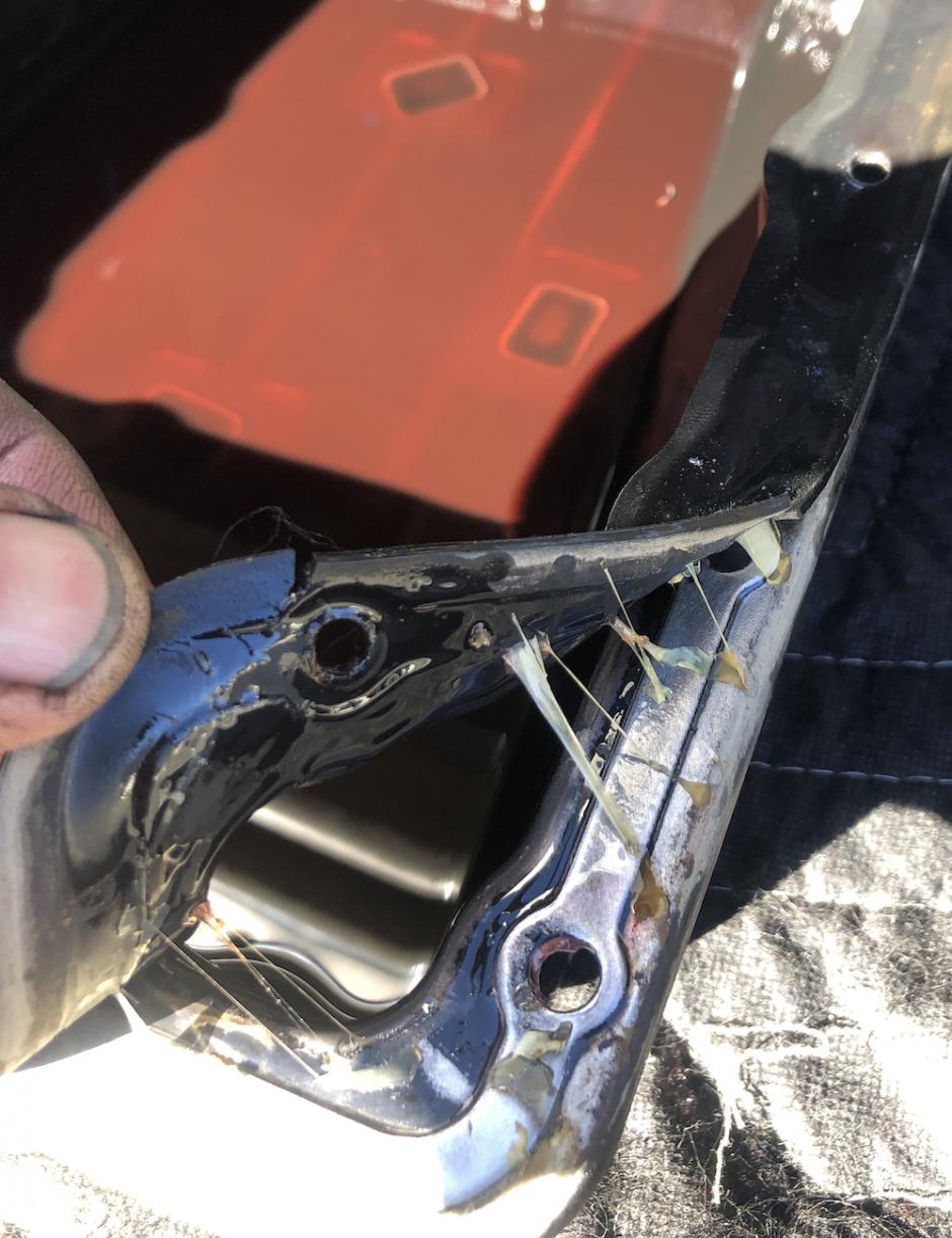

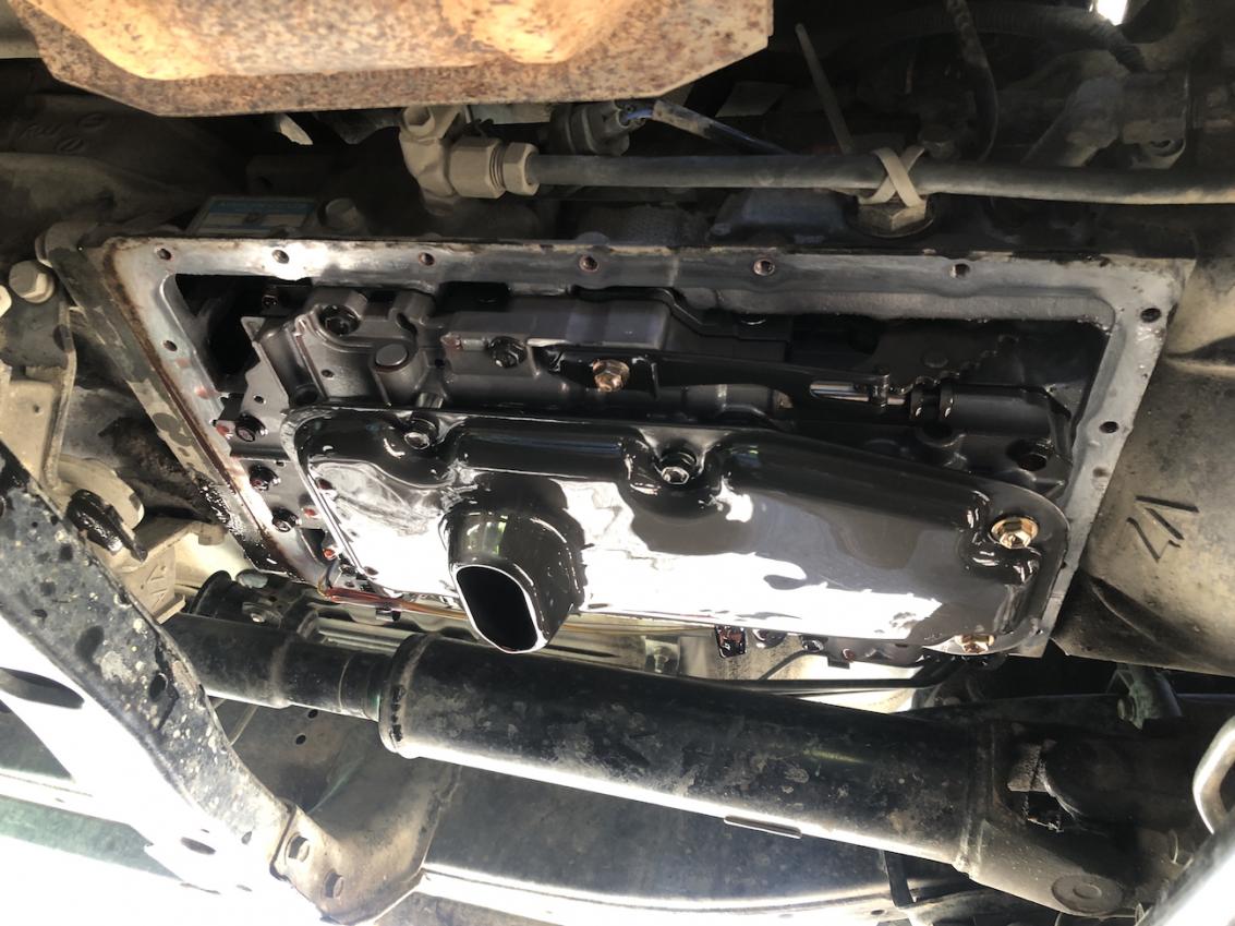

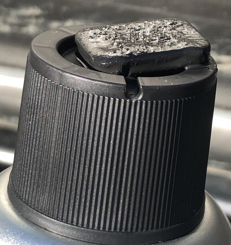

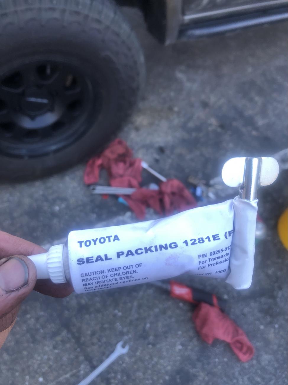

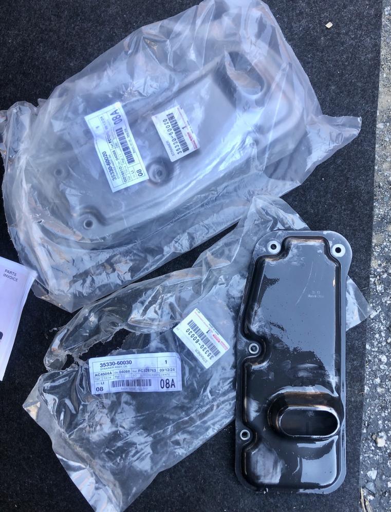

When I finally got around to the job yesterday, my early 2000 used the '30' strainer. Mine also had a rubber gasket that came off with no trouble. I pity the next fool who cracks my pan - I was carefully laying down a nice, thick bead of Toyota 'Seal Packing' FIPG and realized I had been dragging by sleeve through it! Big thick mess LOL but no leaks. I really Packed the Seal on that one!! Decent amount of magnetic sludge.
Couple pics.....
Edit - oops I already posted the Aisin tag
