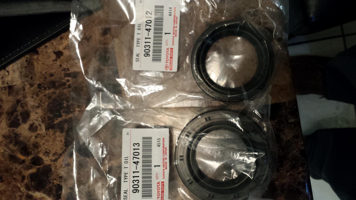

Here are the seals

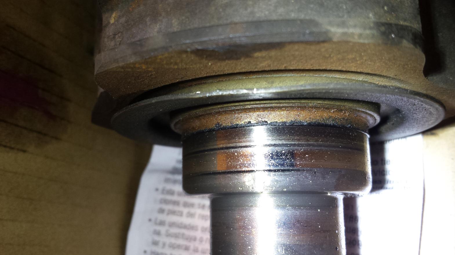

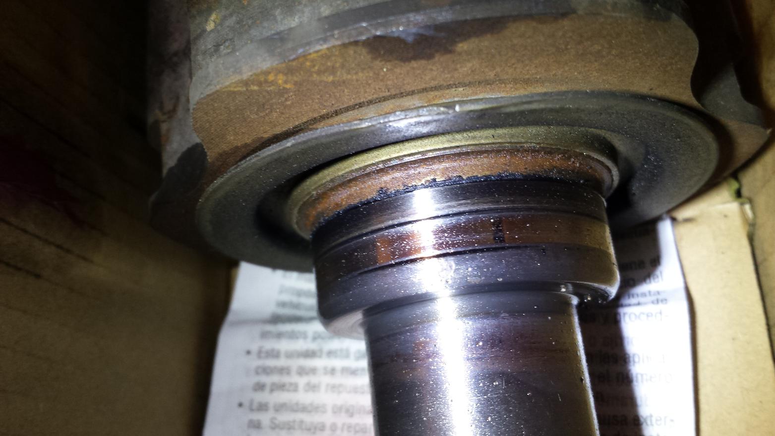

what im trying to accomplish is I replaced my passenger side with a new NAPA one, and i wanted to do is get the old oem passenger side rebooted and slap it in the driver side since its cheaper than buying a new one.
I also noticed i have a little dent on this seal/washer whatever it is and i want to know if i should replace it, if so whats the part #?

You've prolly figured out the new seals pictured go in the dif housing. If they aren't leaking I wouldn't touch them. Try not to hit them when you put the new shaft in.

Personally I'd gently straighten out the dust shield and re-use. There are wiser people than myself who may tell you different. They would be the same on either side, just take off the one that's on the shaft going back as a core and use it.

to be honest i did not know the seals were inside the diff. but it sure makes alot of sense, cause if that said the cvs should be identical with driver and passenger and they only thing making anything driver or passenger orientend is the seals.

Take the best one off whichever shaft and put it on the shaft you're keeping? They're important, but really there's not much to those shields.
