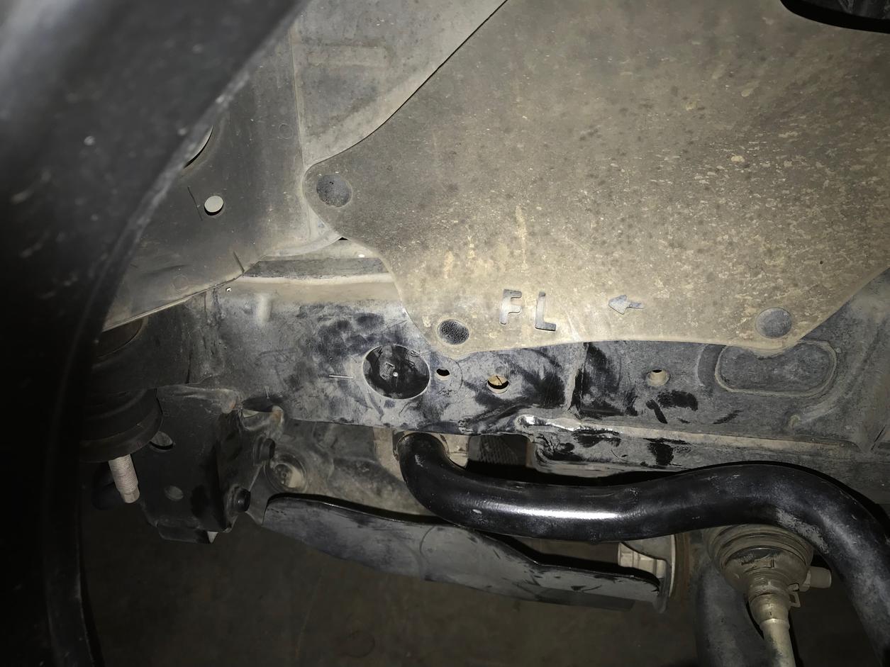

I was installing my front FJ TRD suspension kit yesterday, and when I was removing the sway bar bracket from frame on the drivers side, one of the nuts that is welded inside the frame broke its weld. I was able to saw off the head of the bolt, but now the other half of the bolt and the nut it's still attached to are loose inside the frame.
1) Is there any way to get the nut out of the frame? It looks like the plastic cap above the sway bar might pop out, but I didn't crank on it too hard for fear of breaking it.
2) How can I reattach my sway bar bracket with the second bolt? I'd really rather not have the dealer charge me an arm and a leg for this.

Pop that plastic cap off and fish it out with a magnet. Then put a rivnut in the hole. Some will say you have to weld in a new nut, but a rivnut should be fine. If you do want a welded nut, don't go to the dealer, just go to a welding or fabrication shop.

Update: I was able to break off the plastic cap in the picture above to expose a 7/8” opening in the frame. I fished out the nut with a magnet. I then used a piece of 3/4” wide stock steel cut to a 2” length. Drilled a hole in the steel 1/2” from one end and welded a flanged M10 nut onto it. I chose not to center the nut so that the apparatus wouldn’t spin inside the frame when I was tightening the bolt. I fished the nut/steel into the frame and threaded the new M10 bolt through and BOOM, problem solved. I used a process similar to [MENTION=118321]Jetboy[/MENTION]’s thread from a while back, except I didn’t drill into the frame and weld the stock steel to the inside of the frame. I figure that if it ever has to come apart again, I can just do the same process.
