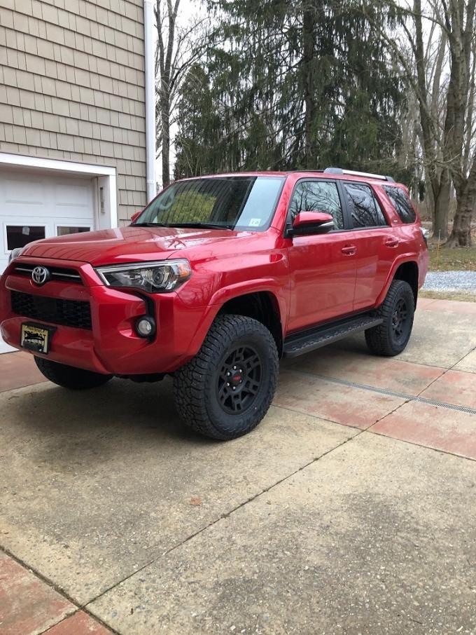

Here's a pic of the results. Couldn't be happier with the look and ride is well improved with the tighter Toytec/Bilstein kit and no increase in road noise from the Falken tires.

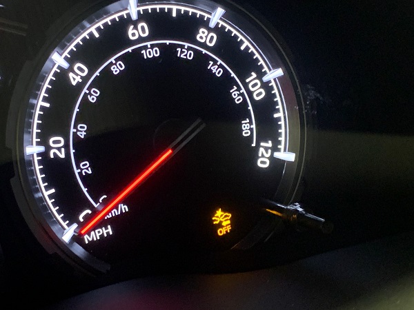

Thanks all .. looks like I'll be heading to the dealership. I don't get any beeps, I only have this light lit up except if I turn on the cruise then set the cruise is when I get the explanation mark triangle.
Why not try the zero point, only takes a paperclip?
