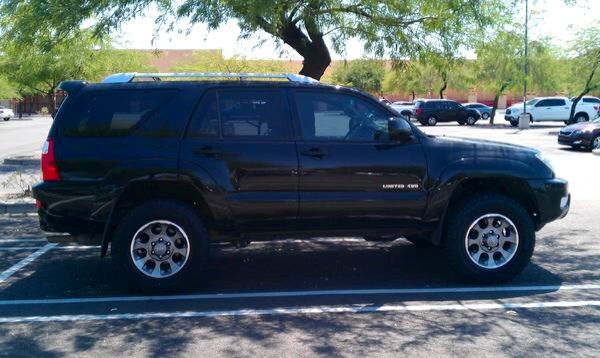

I have acquired my Bilsteins, and FJ springs for my 2003 V6 4x4, and yeah I'm elfin stoked to put them on!
I am not sure if I want them set at .85 or 1.75, but I'm leaning towards 1.75 as I want to upgrade tires to 255/75/17.
Does anyone have this setting??
Here you go. FJ springs + 5100s @ 1.75" in the front. For the rear, FJ springs + 1.5" poly spacer and 5100 shocks. I'm running 265/70/17 Hankook ATMs.

im running 255/70/18(same size as 255/75/17) with stock xreas. so you could go .85 with no problems. i think you could even fit 255/80/17 if you wanted with them on .85
Tires are 265/70/17. 5100's and Moog FJ springs all around, fronts are set to 1.75. Will probably add a small rear spacer.
Thanks! You guys are awesome. :D I was worried that 1.75 might look too high, but alas these photos just reconfirm that it is the way I want to go! I will post pics of my setup once all is installed.

To further solidify your decision:
you can check out my build thread, page 2 for more pictures
