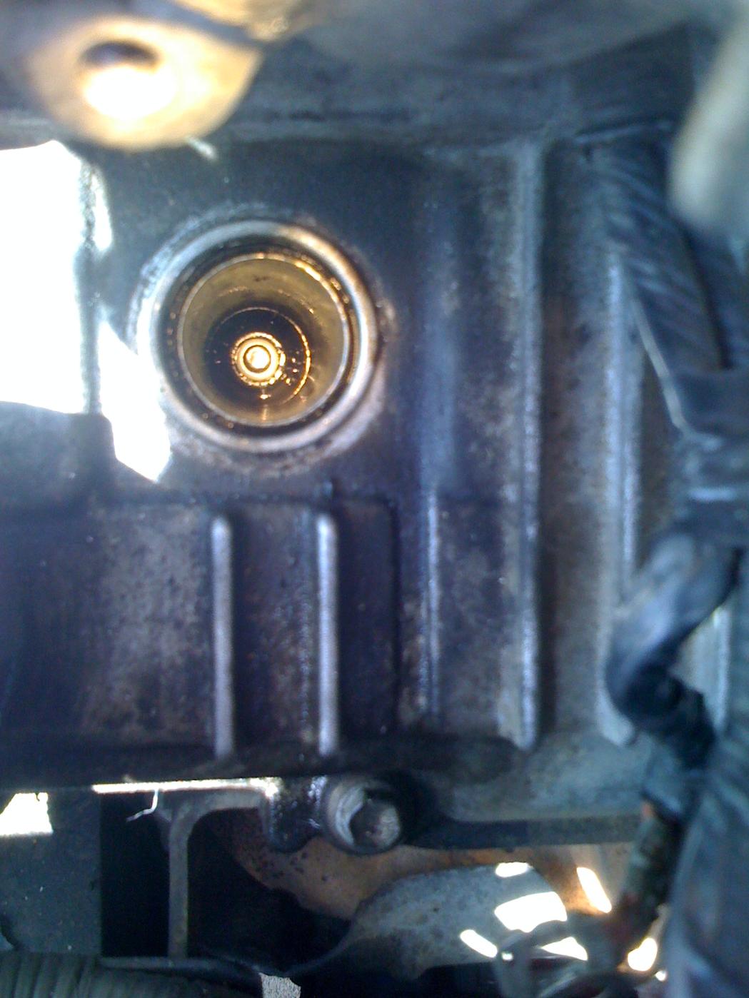

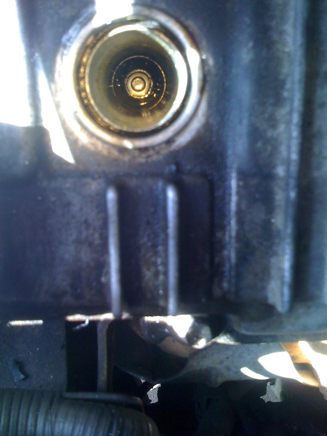

Anyway, the WD-40 soaking it over night loosened it a little. Rubber is only around the base of the plug and is just enough to stop a socket from getting on there. I took a picture and it is actually more legible than I thought it would be. You can see in the picture that the plug is clean except around the base of the plug where the rubber debri is hiding the base of the plug that the socket goes on.
I worked at it for several hours from everything from needle nose pliers, screw driver (too big), dental pics (too short), coat hanger (bends too much) and made some progress but not much. So last night I put enough "Goof Off" in there to cover the rubber over night, hoping it would dissolve it.
Today I am going to try to scrape it with the Goof-Off still in there and then shop vac out the Goof-Off, blow it out with air and continue scraping. I also am going to remove another plug and see if the heat shield tube that lines the hole will come out with the plug removed. If it will I am going to use what I call a "rescue socket" by Irwin that has teeth on it for rescuing a stripped bolt, maybe it will cut through the rubber enough to break the plug free. If it will then I am going to stop as soon as I get it broke loose and blow the hole out again with air before removing the plug from the threads. Then remove the plug and the heat shield and replace it with another shield. I really don't want to pull that valve cover.

Now for the final solution - after I let the "Goof-Off" soak on it over night, the next day I went out and looked at it (pis enclosed) and it was so weird = the goof off was gone! the rubber/silicone that was stuck in there absorbed the entire amount of "Goof-Off" and swelled up like a tampon in water! When I looked in the tube I was shocked to see 1) no "Goof-Off"
2) the rubber was much taller in the tube over night.
3) the rubber was apparently completely unstuck from the tube wall.
So I used the modified hanger described earlier by one of you to pick it out and = it came out in almost one piece - and it was 2" tall! I couldn't believe it! Enclosed is a pic of the rubber after soaking over night in the "Goof-Off", notice how slimy it looks - it came out with out effort.
