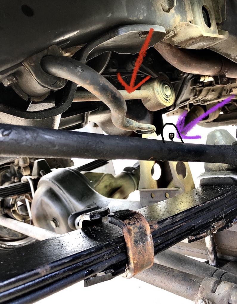

Ok, I stopped by the shop and they showed me the issues.
Can anyone tell me what this part is called? It’s what the red arrow points to in the picture below.
They were calling them trailing arms, but I now know that’s not the correct name. I need to find a longer one so it can connect. (I drew in the part that it connects to because the picture was too bright)

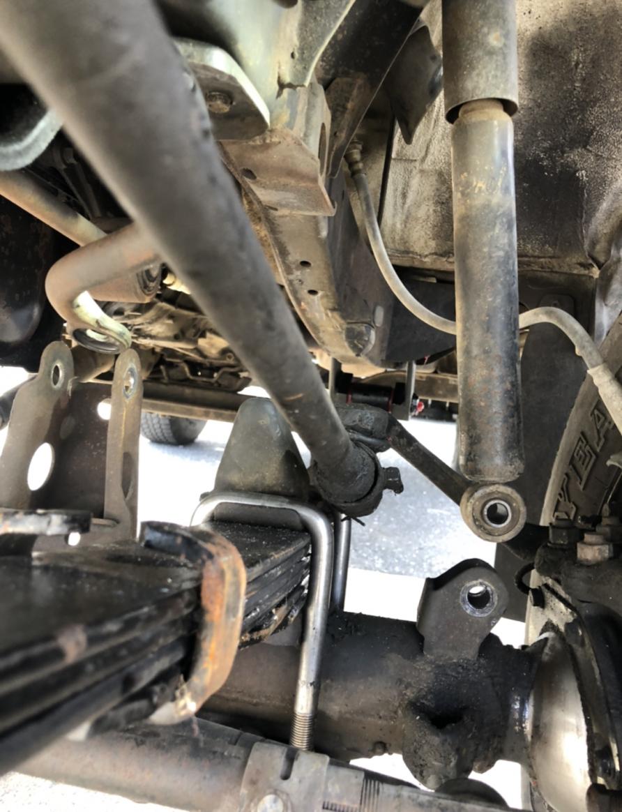

Also, the steering shaft is now rubbing against the leaf springs.
If I went with a high steer / crossover steering kit do you think it would eliminate that issue?
Being an 85, I would need a power steering box from an IFS truck, and I’m a little worried about having to reinforce the frame.
rockauto.com
I live in Canada and this is still the best source for parts, parts come from Texas and California most often. Good price, fast shipping, and wide availability.
Yes, going high steer will eliminate the steering issues and the need for the "controlling arm"
Yes on the newer box. Bracing the frame isnt bad, Trail gear makes a kit that makes is supper easy, good time to push the box forward, since your moving stuff and the steering shaft needs to be lengthened anyway.
IFS Steering Box Mount Kit
I would pull the sway bar off entirely.
Make sure your front drive shaft has enough slip that it doesnt fall out at full droop too, and that your brake lines (front and rear) can handle the new suspension height/travel.
