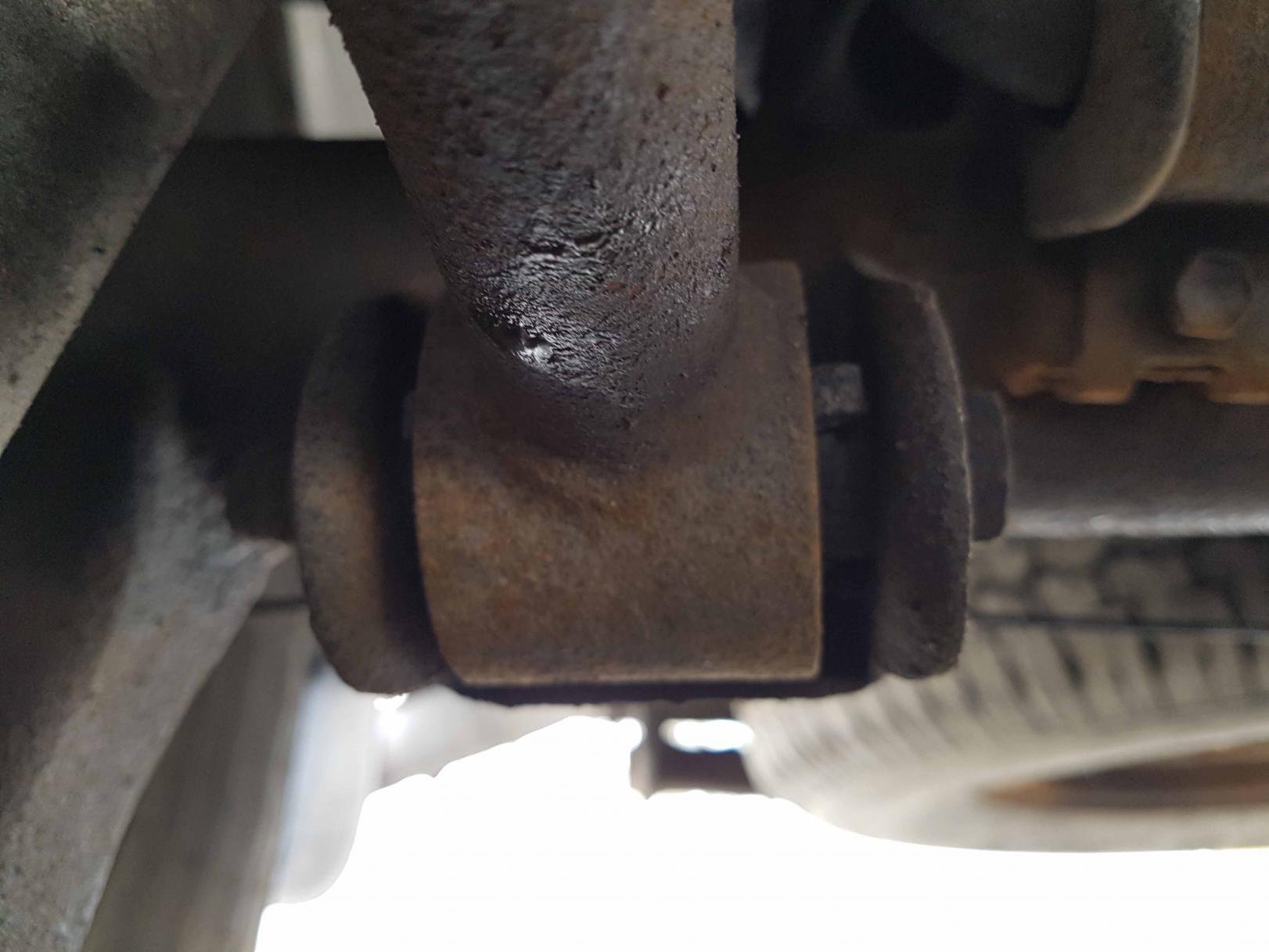

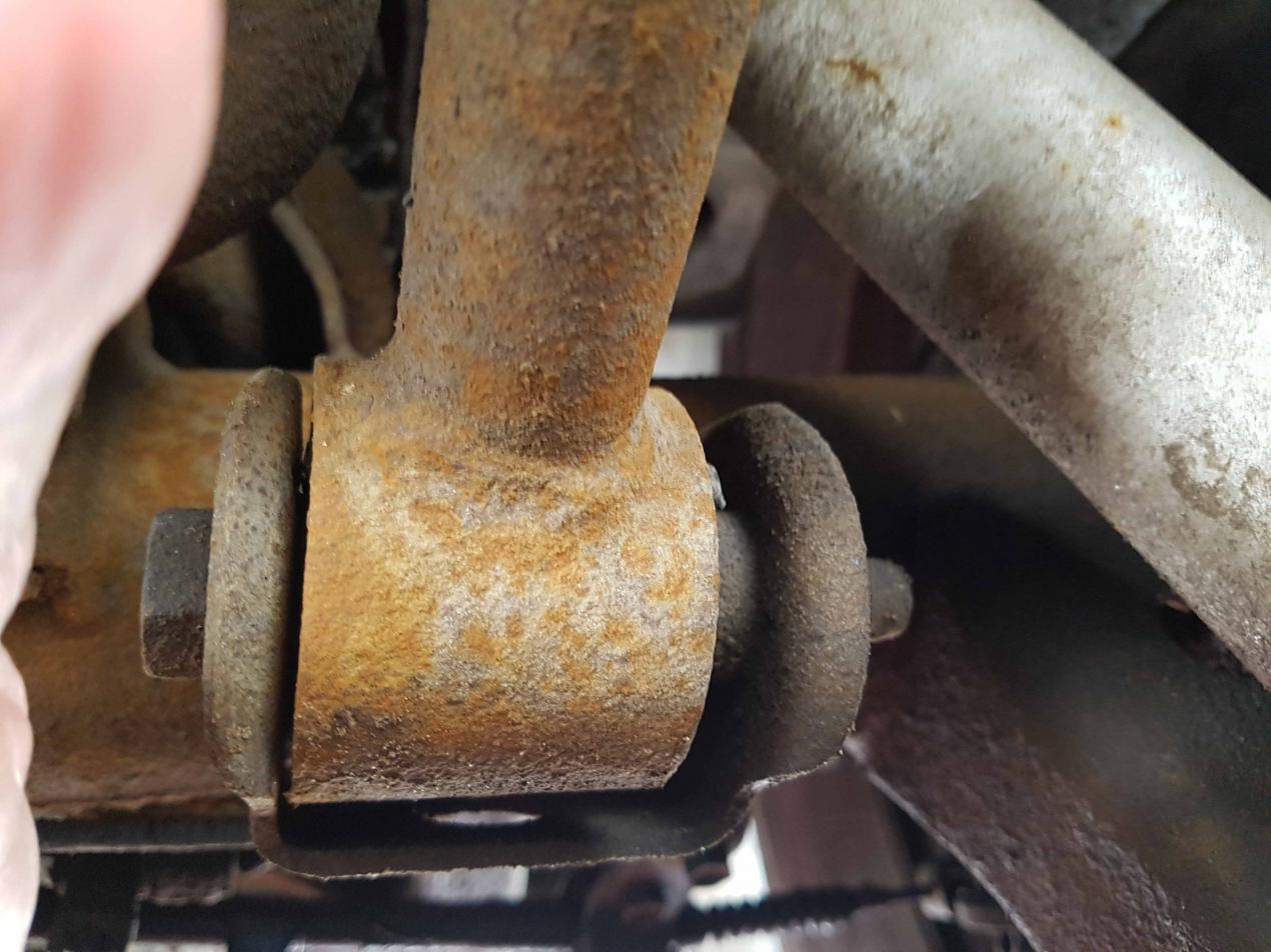

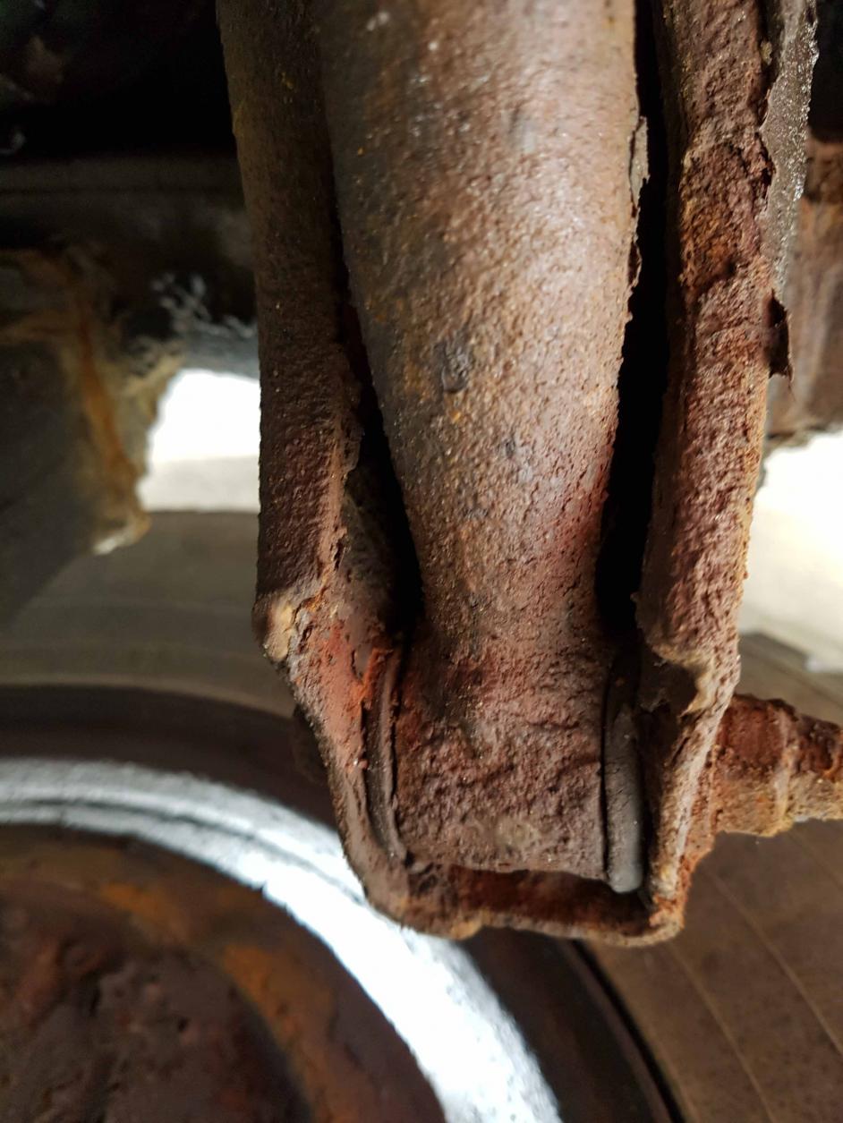

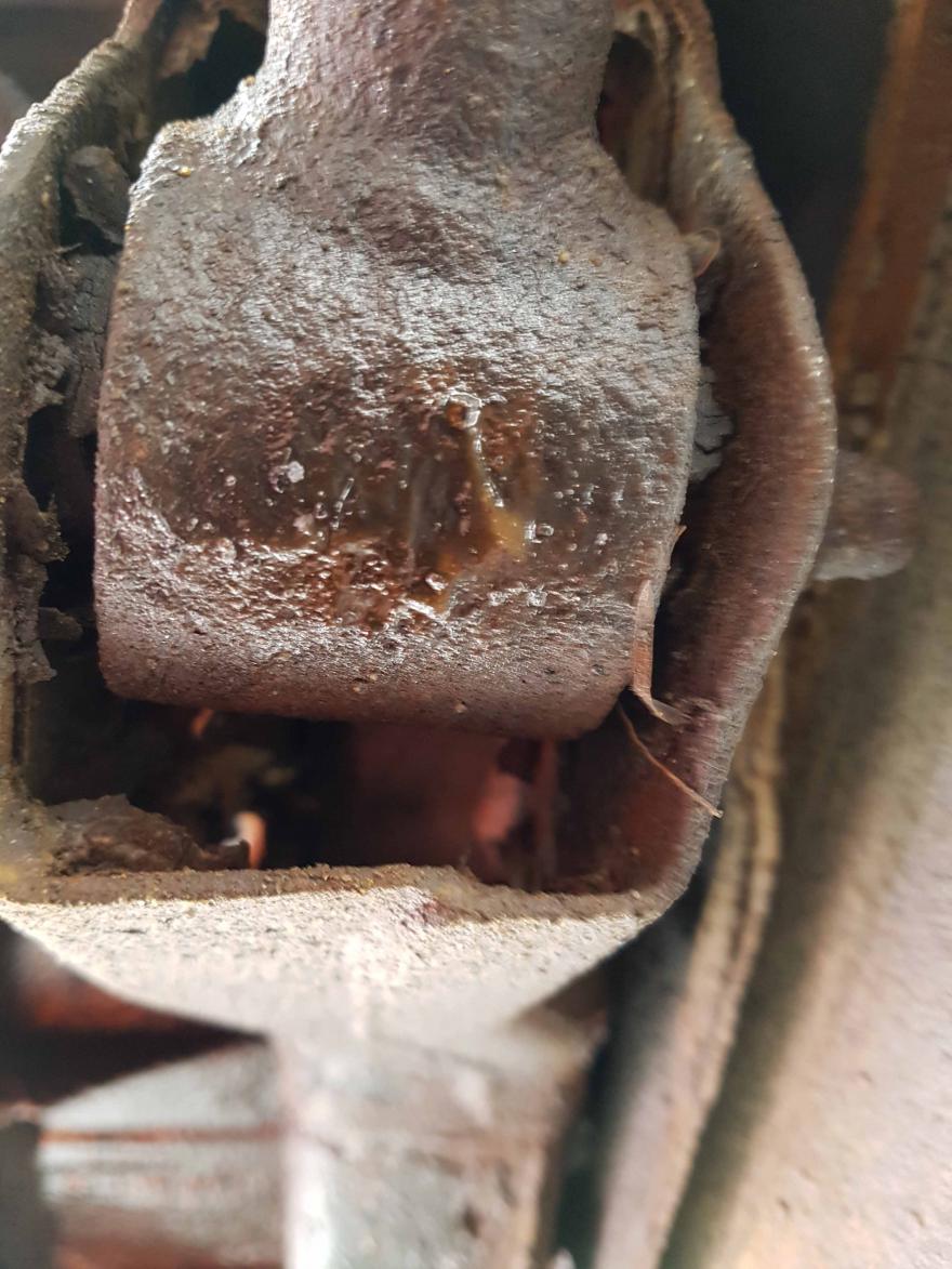

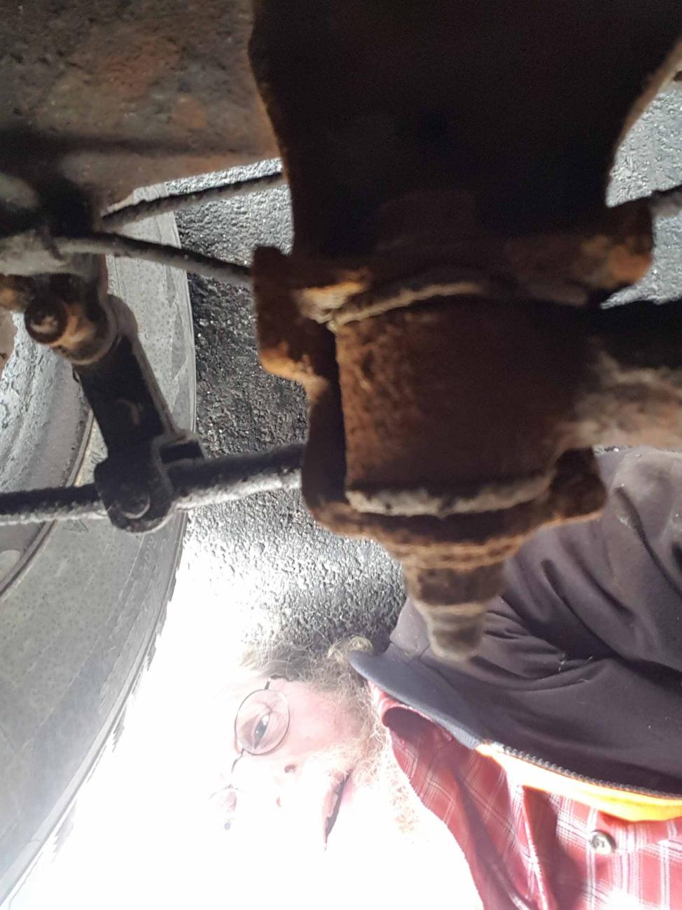

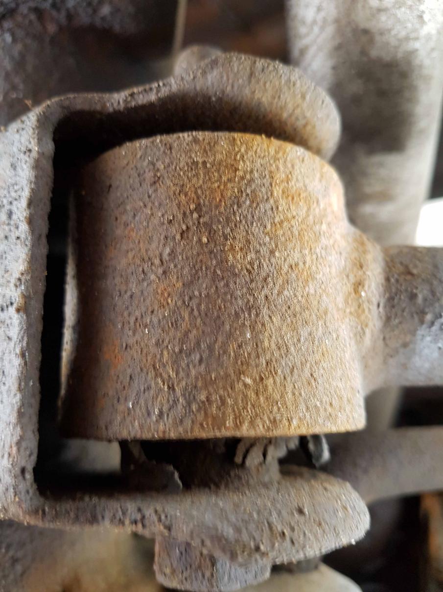

I just crawled under to have a look
the panhard bushings do not look bad - I can't wiggle anything
the trailing arm bushings look bad - bits of rubber sticking out from under the arm, no shoulder on the bushing, quite a gap between arm & the frame holder
I am assuming that the bushings w/shoulder use to fill most of the gap?
I think the arms could move back & forth at least 1/2" (1/4" gap each side)
looks like I'll replace all 6 bushings

here are pics of my bushings
mark

I had the same issue, rear end wiggle. I replaced the lower control arms and it took care of it. I could not tell from looking at them on the vehicle but the bushing were completely worn out.
