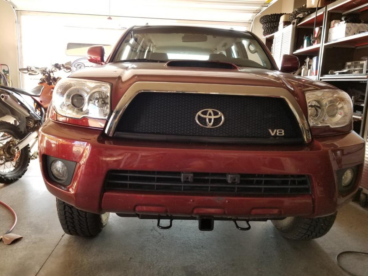

Yes -these were a pita. I replaced my grill with a flat mesh/ satoshi look. I was able to get about half of these off. The other ones I had to fight with as they were rusted and stripped. I drilled, cut etc. to finally get it all off and now my grill is held on by half the previous number of nuts, but it works
It's worth it
I broke the 2 clips on the top middle but the sides were good so I figure It'll do. If I need to get a new grille, I'll pick up some via aftermarket on ebay.
