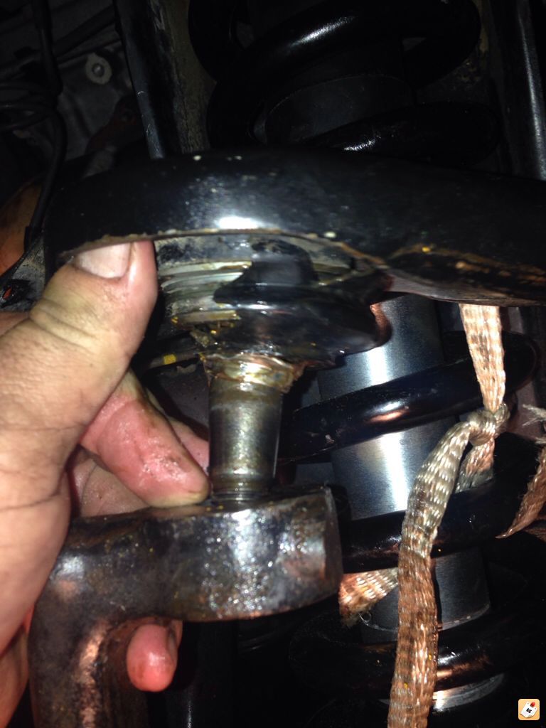

Excuse me for being a noob but I can't figure out how to remove these. I've got everything undone except the bolt on the balljoint connecting the arm to the spindle. Any tips for getting this sucker loose?
It looks like the ball joint boot is wasted already, just us a pickle fork in between them and wacke it with a hammer. Done.

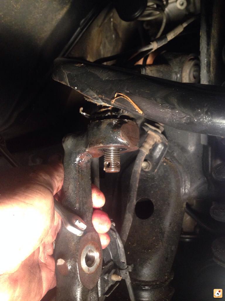

Thanks guys and yeah lol my light racing UCAs came with bushings so I showed no mercy on the old ones
Ive always heard, "hit what it goes through" so in this case, give a good whack with a hammer to the spindle. Its never failed me, hope that helps
Success! Pickle fork didn't work but the pitman arm puller came through.

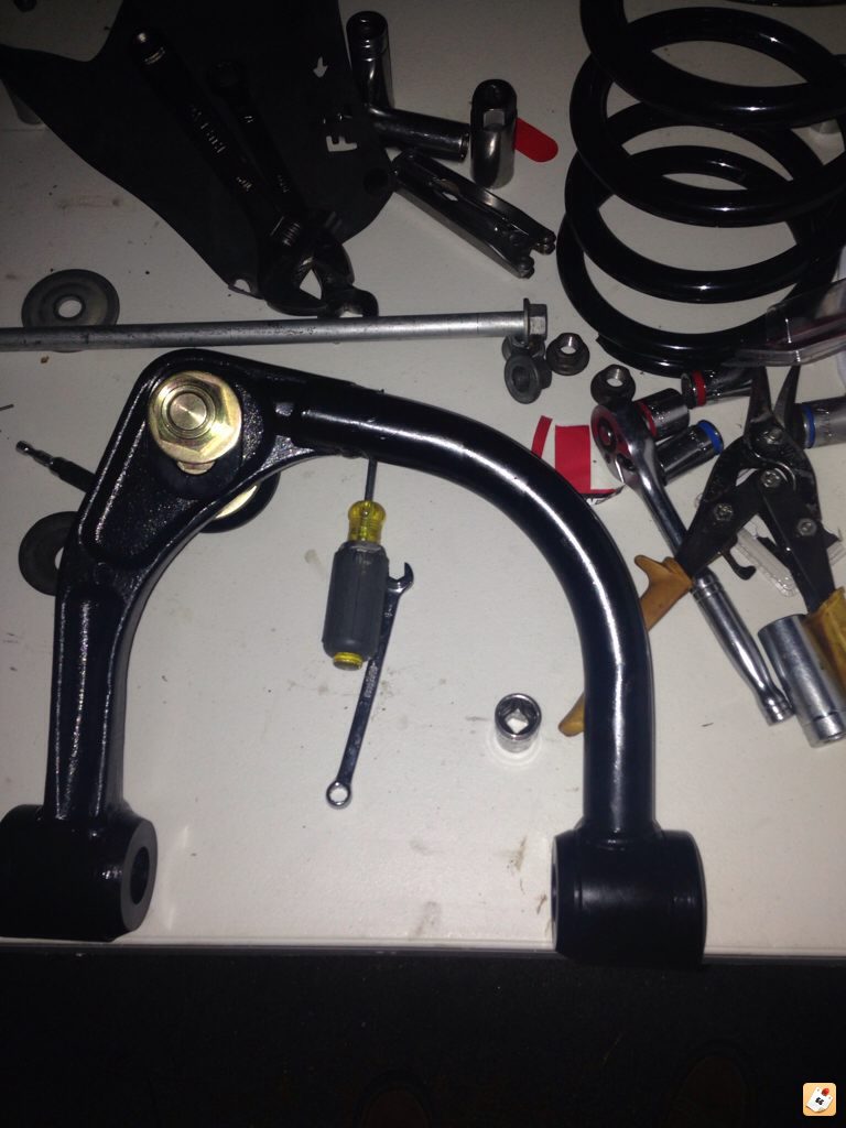

now time to put these bad boys in

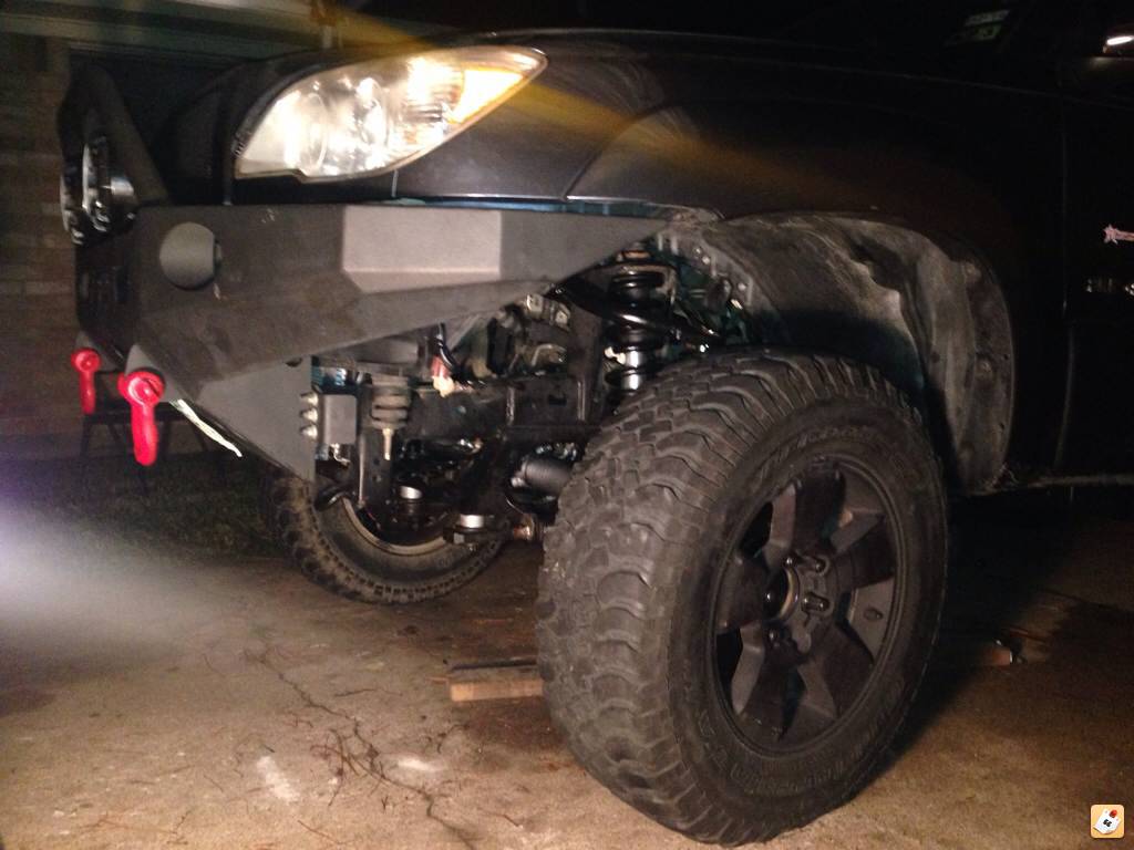

Thanks for all the help again guys, anyways here's how the front ended up. Shiny new UCAs compliment the Bilsteins and 885s. Time to get these 5160s and superflexes in the rear and then go get an alignment!
