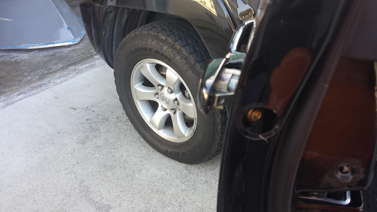

Okay, finally got around to disassembling the door again to try and align the propeller to the new actuator. I was set to remove material at will from the the new actuator until I noticed the rubber cap on the side of the door, popped it out to reveal a torx bolt. Loosened the bolt and the lock mechanism that's connected to the propeller was free to move out, pushed the assy (w/propeller) right back into the actuator...DONE!! Picture below:
