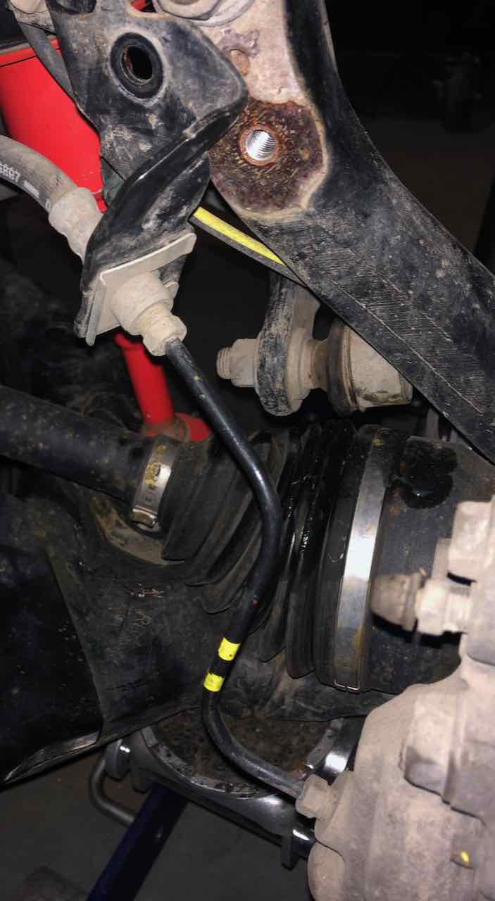

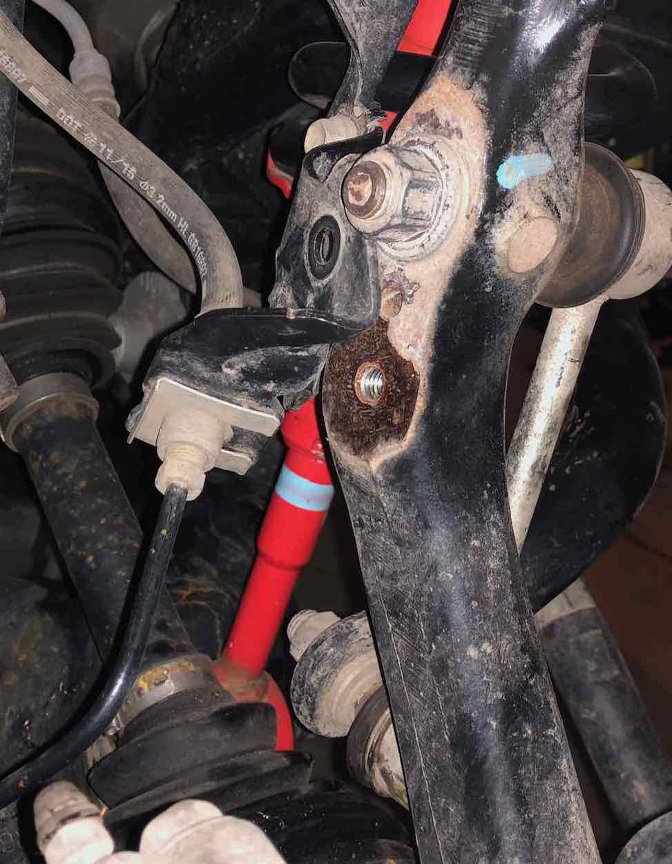

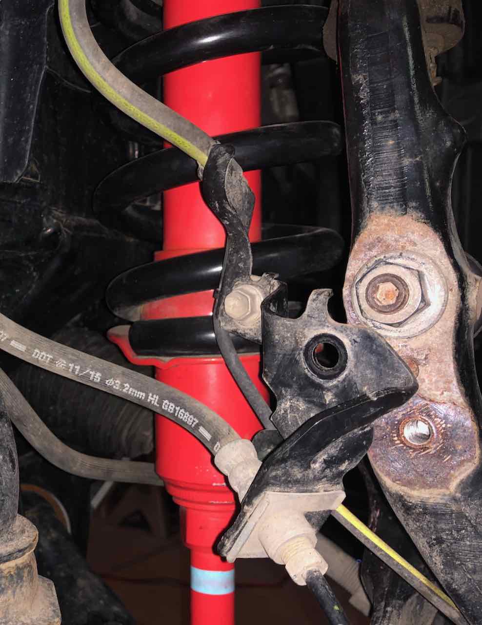

Hi all,
After lots of searching, I cannot find a solution.
Vehicle: 2016 4Runner Limited (with XREAS)
Spacer Lift: Daystar, Toyota 4Runner 2.5" (front) + 1.5" (rear) Lift Kit (Model: KT09134BK)
Issue: Front brake line bracket that attaches to vertical arm does not align with bolt holes. Issue appears that the hard brake lines are preventing alignment. Pictures below.
Attempts: Jacked up the lower control arm to change the angle, no improvement.
May I please ask for your help -- any ideas?
Thank you in advance, T

I'm sorry to revive quite an old thread but I've been trying to figure out what that bolt is that attaches that bracket to the arm like that. I just replaced my front brake pads and rotors and one of them screws stripped out and I've been looking everywhere for it. I own a 2020 4Runner
I think it’s an M8x20
See Part number for brake bracket bolt?
You could retap it for whatever tap you have one or two sizes larger.
Oh man thank you so much! I've spent so long trying to find out what that bolt is. I think I might have that on hand since I went to O'Reiley's and they helped me out as well (I just haven't tried them yet because it was a fairly long day). Might get a few extra though and probably a tap and die set too while I'm at it.
