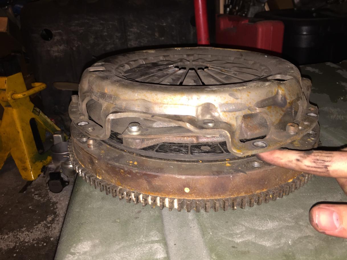

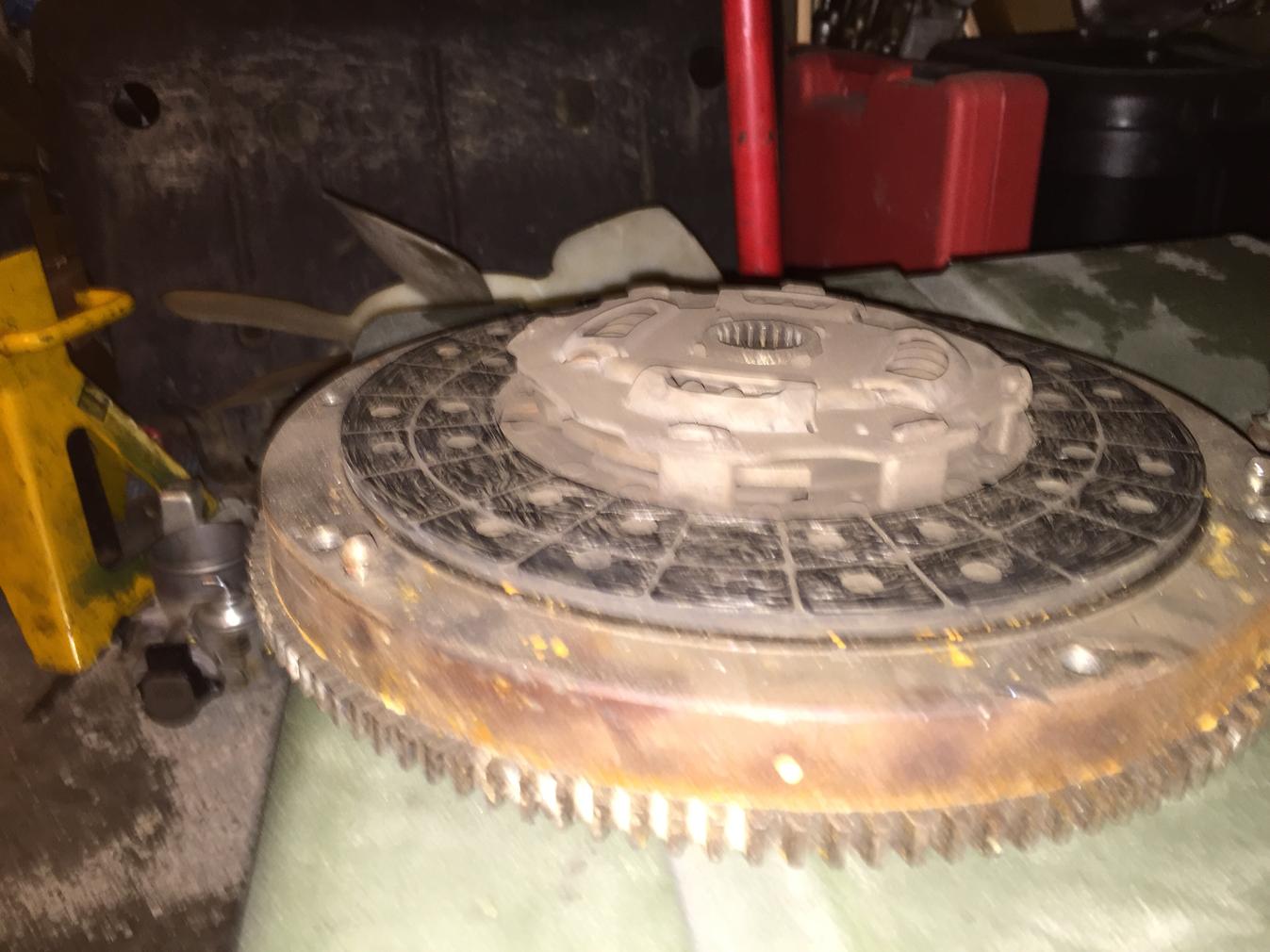

Pictures to confirm. The clutch plate only fits one way. Springs toward flywheel. Pictures are of the springs facing the pressure plate, when which the pressure plate can't sit correctly
