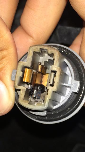

I'm guessing this means I need to change it out?

Er... Yeah. That's exactly how mine looked prior to splicing in the new ones. This time, after you splice in your new sockets, install LED's and you will never have the problem again.
[MENTION=89791]preacher35[/MENTION]
Actually the one they sent me was a new socket! so all i had to do was unplug it from the other side C:! Works like a charm now. Got it off Amazon for 7 bucks.
