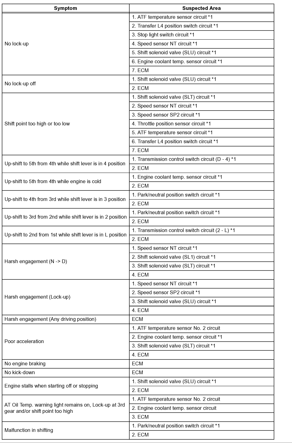

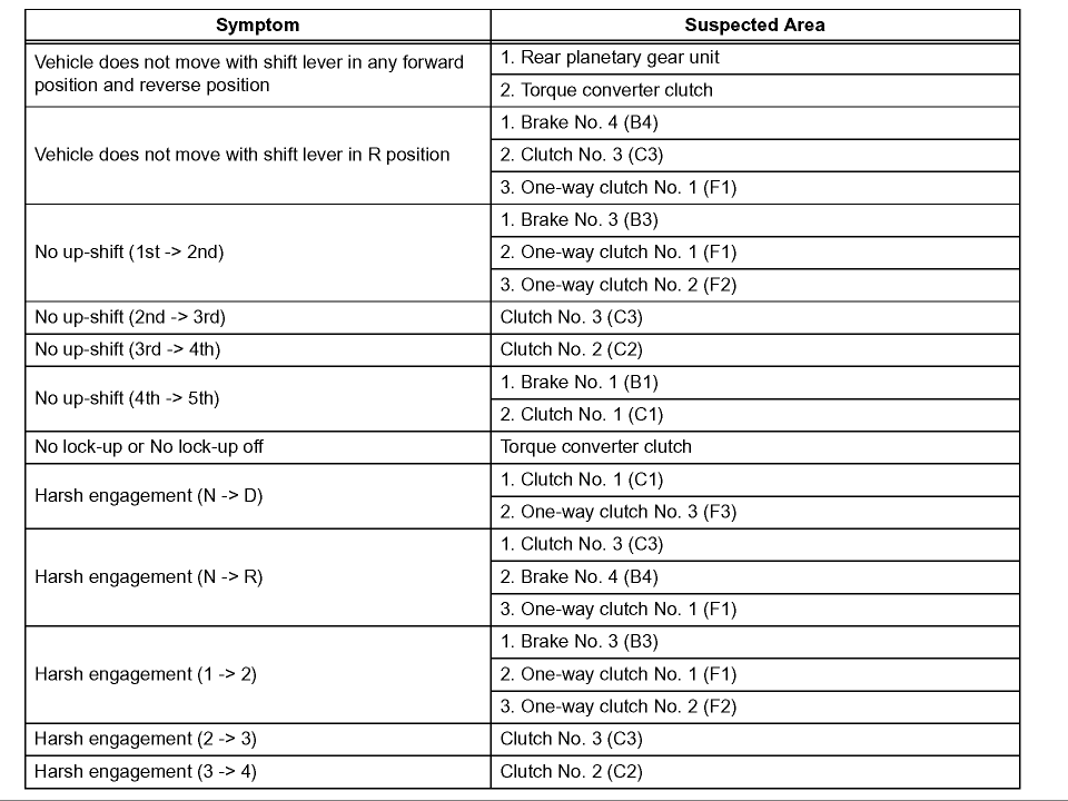

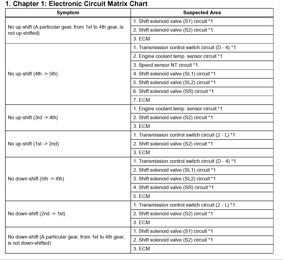

Did you try turn on and off the differential lock button? And see what happens. Trying putting it in neutral and try changing from 4Lo to 4Hi and vice versa, basically all the different 4wheel drive options and cycle through them to see if anything is stuck.
I would say bring it to the shop at this point, you dont want to be messing with anything transmission related. It could end up costing you big bucks if you mess up.
agreed, could be something simple but probably should be towed to a shop at this point. what year/miles?
Help?

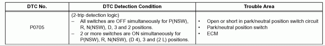

Thanks for the responses and diagnostic table. I found that by driving it (on the way to dealer) in 4 high with the center diff locked the vehicle will shift fine (?!). After a few times of engaging/disengaging 4WD while driving it... it started to shift properly again in 2WD (??!!). The check engine and VSC lights were on so I got a scan that read code P0705. After having the truck scanned the CEL and VSC lights went back to normal. Everything seems to be working fine now. Should I be relieved?
The FSM has a complete diagnostic procedure but if everything is ok now it probably wouldn't tell you anything meaningful. The FSM pdf file name is 028005.pdf or you can find it by searching the all file contents for p0705.
I wouldn't be. If your on warranty then I would have the dealership replace something, even if its not a sure fix, there is/was obviously a problem and not a glitch since reseting (disconnecting the battery) the ECM didn't fix it. If your not on warranty then I would just monitor it closely and not take it on any long trips or to the boonies for a bit just to make sure it doesn't happen again.
What I have come across here lately is the transmission connector getting full of moisture. Might be something to check while you wait for it to happen again.
mine is a 3rd gen but I had a similar problem recently. The transmission Range sensor and the neutral safety switch is the same part on my rig.. Nobody around here knew that. I tried the new range sensor. BINGO! Problem solved.. And everybody was telling me it sounds like "a big electrical problem".. nope.
