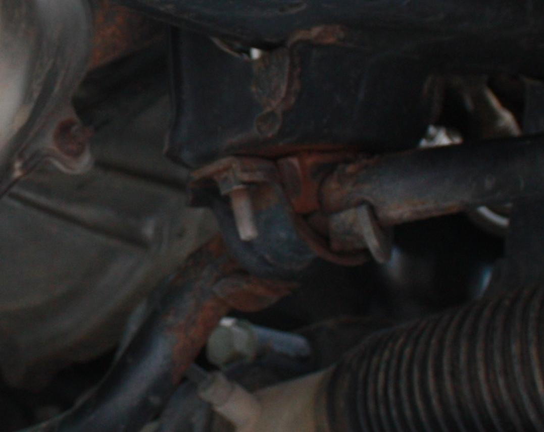

I had two front end rattles when I bought my 2002 T4R.
One was a loose skid plate bolt.
The other was this!
Anti sway bar bushing totally shot.
Good idea to check these out while you are under there.
