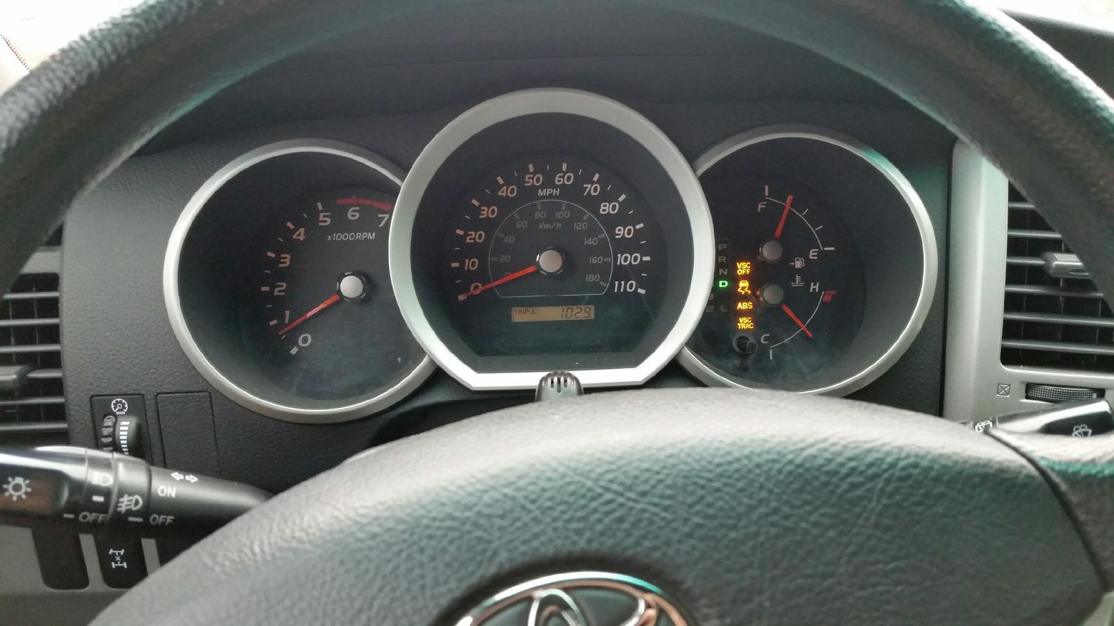

Hey [MENTION=44866]ARK_SWAMP_RIDER[/MENTION], did your dash look like this picture?? If so.. i think this will help nail down what i am seeing... although mine is coming on while driving randomly..
I have the same lights on mine! I tried a zero-point calibration, but the vsc and abs lights blink back and forth and if i start it again they come back as they were before. Am I just doing the calibration wrong, or is the actual abs wire damaged?
I remember reading somewhere depending on how it flashes, it tells you which side is damaged. Anyone have an idea where that information is?
