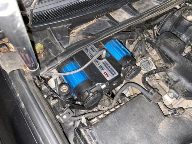

Ok, jumping on an old thread to see if I can get some help as well.
I have an ARB dual compressor installed with the arb locker manifold and pump up kit in the front passenger side of the engine bay.
I have a Viair tank installed in the spare tire location from a previous compressor installation. I would like to connect to the dual ARB compressor to this tank.
All of the diagrams I have seen show the compressor connected to a tank and then the tank to the locker manifold. Do I have to do it this way? Can I connect from the current pump up valve location directly to the tank? I’d like to not mess with the locker manifold connections if possible.
Also, do I need to connect some type of pressure sensor or switch to the tank as well?
Lastly, the compressor is in the front and the tank is in the back. Other than running long lines, are there any other negatives to the distance between the two?
Thanks in advance for any advice, thoughts, criticism or any other type of comments!
