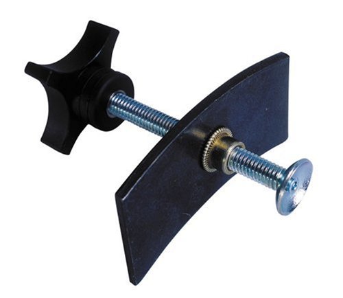

I would recommend getting a brake pad spreader tool from an auto parts place. It pushes the slave cylinders in to make room for the new, thicker pads.

Granted I've not replaced the front pads yet on my 4runner so I might just be missing something here, but how would that spread work with our fixed calipers up front? There's no notch to stick the spread through like on the floating calipers in the rear...not sure if you can fit that spread in between the pistons captain.
The way I usually spread the pistons on fixed style calipers (without removing the calipers and with the rotor in place) is by removing all the retainers/pins and while leaving the old pads in place, take a c-clamp to the top edge of the pad and the outer body of the piston and just slowly compress it; then rinse and repeat for the other side of the caliper.
The trick is to hold the c-clamp a little slanted so that you can get enough surface area on the body of the caliper to clamp against. It helps to have a c-clamp that has a pivoting head like so:
I've done it this way a few times already on other vehicles and I've not had any issues with pistons popping back out while you clamp one side, they usually stay put for the most part and go back in fairly easy. Not sure if this helps or not, but I've always uncapped the master cylinder to reduce the amount of pressure build up in the hydraulic system while you are pushing the pistons in and the fluid back up and into the master cylinder.
